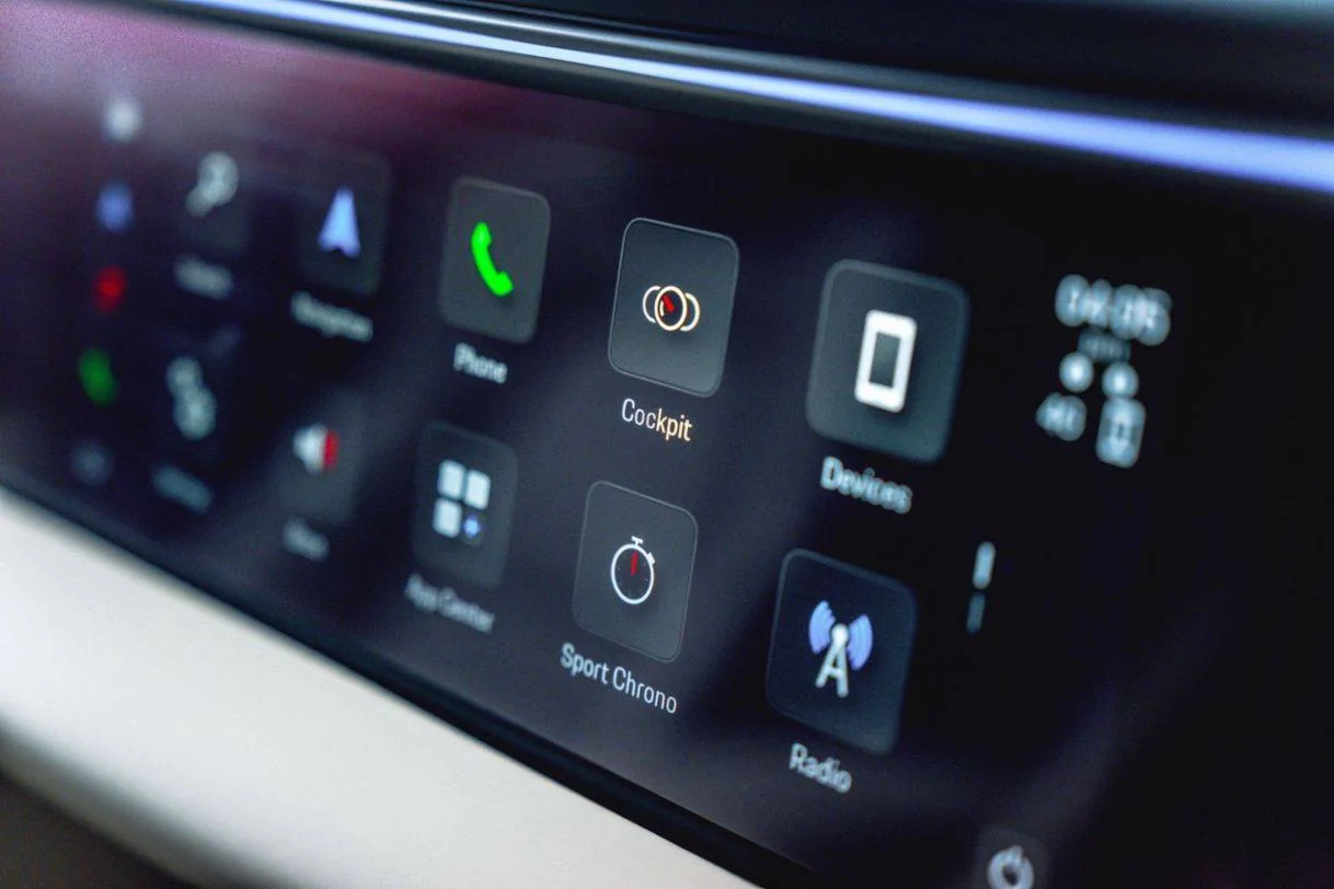

Quick question: why does my PCM look like this?
Electric Macan EV Macan EV PCM — Tips and Tricks 1730599204979-y7
And your interface @nulled looks quite different (bigger tiles, customizable background). Am I missing a recent update?
Can you share your OS version. It's in Settings -> System. I wonder if they forgot to update yours or if Porsche are bringing the old UI back.
Mine is:
SQ1D.220205.004

Mine is:
SQ1D.220205.004
Thanks, I have the same build number, but the Android security patch level is from December 5, 2023 and the Android kernel is January 26, 2024. Other cars I’ve seen on the dealership floor had more recent dates on these lines, but that’s the only difference I could find.
So maybe I’m behind on the Android version, but it says there are no software updates available when I try from the PCM ?‍♂
