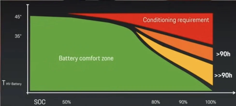

The car lost 5% while parked for 5 days. The loss was mostly sudden after the third day.
@chrisk regarding your 5% loss. I am wondering if you had the vehicle at a fairly high SoC or it was pretty hot on that day. Watching the Out of Spec video reminded me of the somewhat unique feature of the vehicle. It will self discharge to save the battery if it is left at a high state of charge or the temperatures are extreme. In Kyleā€˜s video, he said something like 90 hours before such action is taken but this was based on information provided before the actual launch.

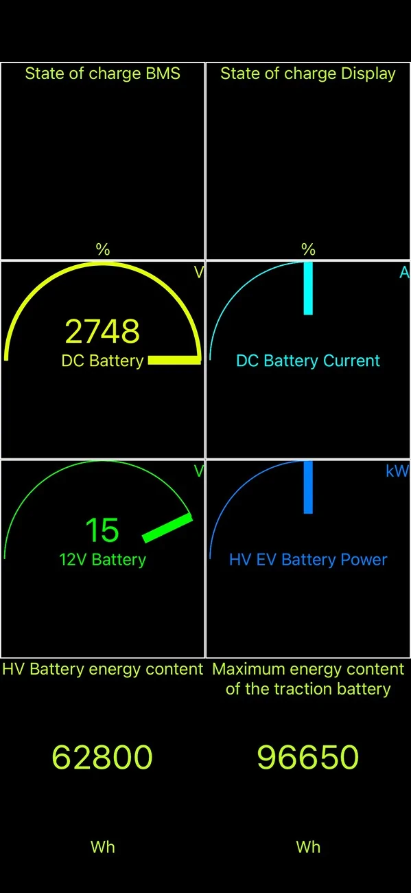

Anyway, on another note, the software update made CarScanner + OBD worthless (it was not the best tool, but it ā€œworkedā€ before the update).
In my quest to understand better the battery charging capacity at different temps, I tried to use it again after the update. All PIDs have changed, and the info in CarScanner after the update is complete rubbish.
So if anyone has a working App + OBD reader after the software update, please post.
Carscanner still works after the update, just as badly.
With a 70% Soc (68% the day after)
Electric Macan EV MY26 software update (week 36) for MY24-25 IMG_0316
697
517
Well the sensor data is for me completely empty which in the past was not the case for me … and values that where in the past correct are now completely wrong …
Im speaking about that long list … that is for 99% empty now, for me.
You are lucky with an max energy capacity of 96.6kwh that is over spec 😬
The Max Energy Content was currently about 93 000.
A month ago , after ten days in my garage, my Soc loss 10 % and the M E C down to about 51000 !!
The maximun range has also dropped in the same way.
The same day as the update , my dealer "reset" the BMS and all seem to be ok now.
The range calculator , which has gone crazy, was still crazy.
I made a PCM factory reset , at home and it seems to be working fine now

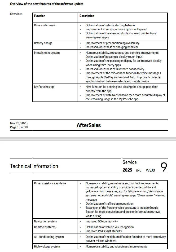

NHTSA published the update information now:
MC-11026364-0001.pdf
MC-11026365-0001.pdf
MC-11026338-0001.pdf
MC-11026337-0001.pdf
MC-11026335-0001.pdf
MC-11026329-0001.pdf
Nothing we didn't already know, relevant bit is the changelog:
AI summary based on the pdf’s
🚘 WSJ0 – Software Network Update VR28.13
What’s improved or fixed?
āš™ Drive & Chassis Improvements
  • Smoother vehicle starting behavior
  • Faster and more accurate air suspension adjustment
  • Prevents false e-sound warnings to the driver
    MC-11026329-0001
Effect: Less hesitation when starting, better ride response, fewer confusing alerts.
šŸ”‹ Battery Charging & High-Voltage System
  • Improved pre-conditioning availability for DC fast charging
  • Increased charging stability and robustness
  • Many reliability improvements to the HV system
    MC-11026329-0001
Effect: More consistent rapid charging and fewer failed charging sessions.
🧠 Battery Capacity Calculation Fix
  • Includes a plausibility check
  • Can reset battery learning values if incorrect
    MC-11026329-0001
Effect: Fixes range calculation errors — especially if the estimate becomes inaccurate over time.
šŸ“± Infotainment & Connectivity Fixes
  • Better passenger display touch and third-party app behavior
  • Stronger Bluetooth connection reliability
  • Improved microphone clarity for CarPlay / Android Auto voice messages
  • Improved contact syncing between phone and car
    MC-11026329-0001
Effect: Fewer disconnects, better hands-free communication, smoother UI experience.
🌐 Mobile Data & Navigation
  • Improved 5G connectivity
    MC-11026329-0001
Effect: Faster loading of maps and online services.
🧭 Driver Assistance Systems Fixes
  • General stability and comfort improvements
  • Fixes false warnings, including:
    • Fatigue warning
    • ā€œAssistance systems not availableā€
    • ā€œClean sensorā€ alerts
  • Better traffic sign recognition
  • Porsche Voice Assistant upgraded to use Google Search
    MC-11026329-0001
Effect: Reduced nuisance alerts and more accurate assistance behavior.
šŸ— Comfort, Keys & Parking
  • Improved key detection, reducing ā€œkey not recognizedā€ issues
  • More stable ParkAssist operation
    MC-11026329-0001
🌬 Heating & Cooling
  • Better dehumidification logic → Prevents fogged interior windows
    MC-11026329-0001
šŸ“² My Porsche App Enhancements
  • New ability to open/close charge port from the app
  • More accurate remote range display
    MC-11026329-0001
