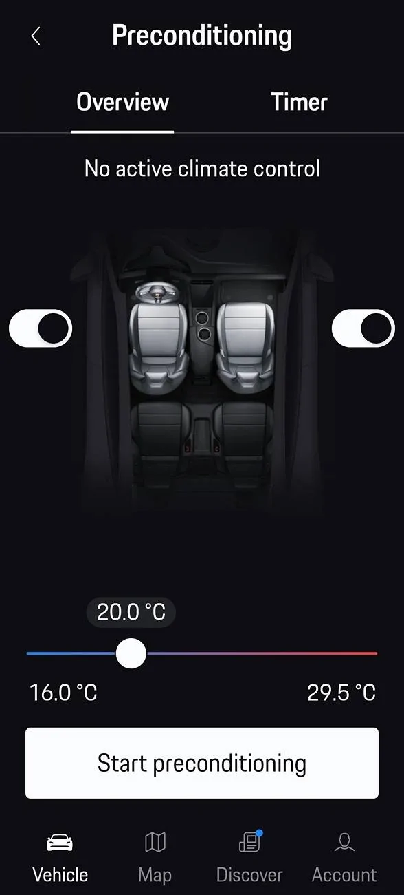

That is my question to make sure I understand it right. Let’s say I want to set a timed heating at 7am in the morning but I only want it to be 65F instead of a predefined number. Right now it is giving me 88F. Is that because I had it set in the car last to 88. That’s why it gives me that ? As I don’t see a way to change it in the app. Unless I just hit the pre climate button for right away temperature.
That's correct.
In the app you just slide the sliders to the temp you actually want.
Screenshot is from my Taycan and I have all Porsche Connect services.
