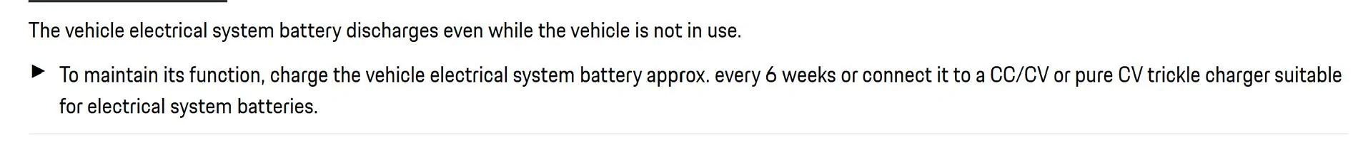

I recently returned from a 2-½ week vacation to find I couldn't get into my Macan 4. The 12-volt battery had discharged during my absence, and so the car couldn't be unlocked. Access to the 12-volt battery is through the hood, but there is no mechanical way to open the hood. The only other way to open the hood is though a cumbersome process which requires an external 12-volt battery (see the manual on "emergency hood release"). In my case, I was advised to have the car towed to my dealer, who opened the hood and was able to jump-start the battery for me. The process took almost an hour for three experienced Porsche mechanics. I hate to imagine having to do this myself far from home. I do own a 12-volt portable jump starter, but having it in the car would do me no good since, with a low battery, the hood is not accessible. This seems to be a serious design flaw. It appears that the battery draws quite a bit of juice when just sitting, and even a new battery (my car was just 3 months old) may not be up the job.
From now on, when I go on vacation for a week or more, I'll connect a trickle charger. You might want to do the same.
