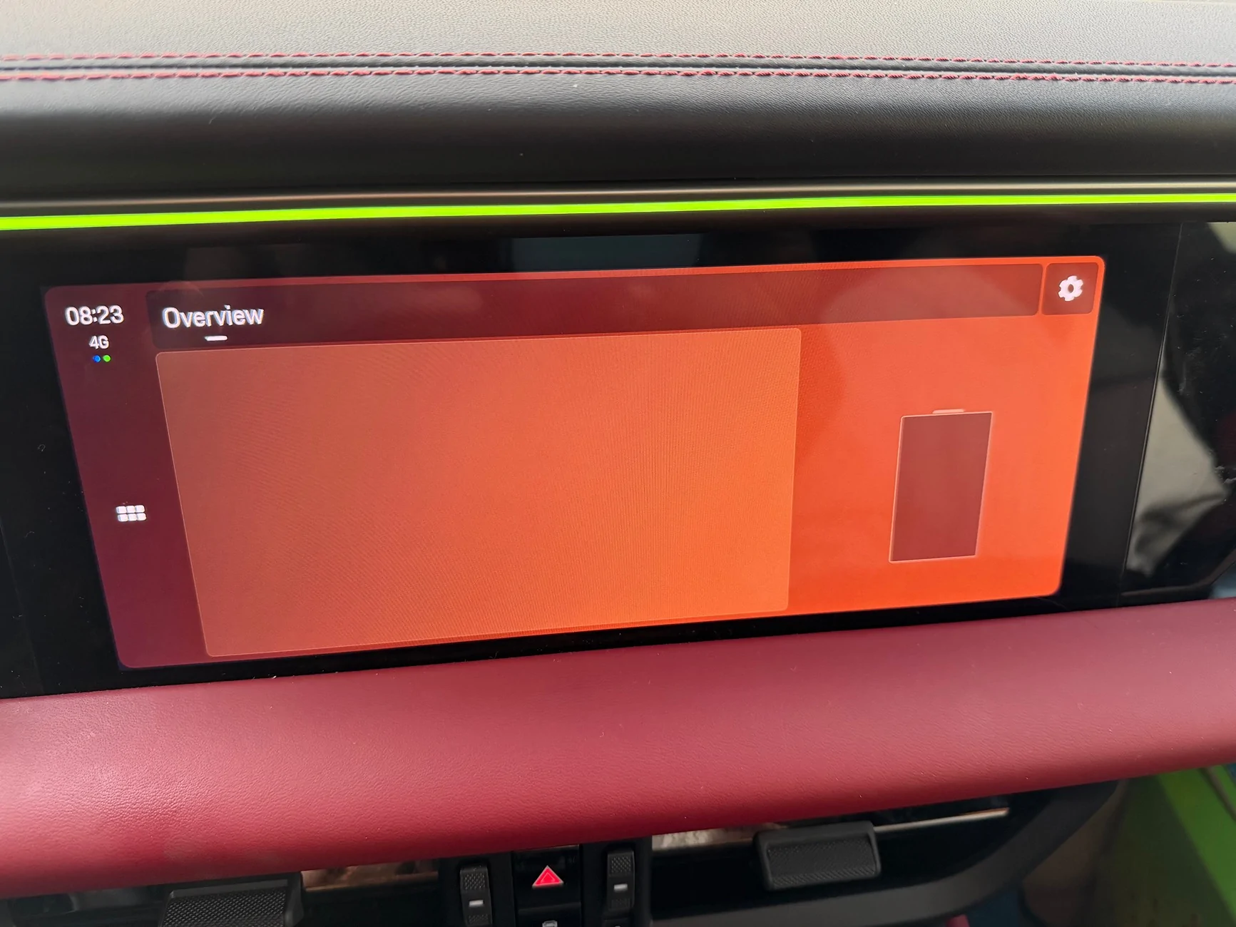

Electric Macan EV VR28.13 Software Update IMG_0282
The update has been reliable, but today as I was charging at EA, this was the battery screen. It continued to charge, was drivable, and it later returned to normal after shutting down the vehicle for a few minutes. So still some bugs in the software.

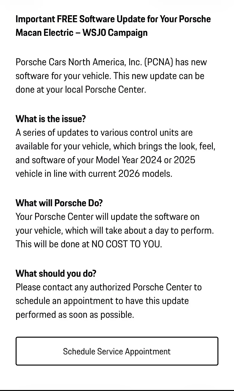

How do I do the update? Does it have to be at the dealership? The one near me is not the one I bought the car at, would they do it for free (and give a loaner) or do they charge for it? Also is it gonna take more than a day?
Has to be done by the dealer. I don’t believe you have to take it back to the dealership you bought it from. As long as it’s a Porsche dealership and your car is still under warranty, you should be able to get it done for free. I am not 100% sure, but you could call the dealership closer to you to confirm.
