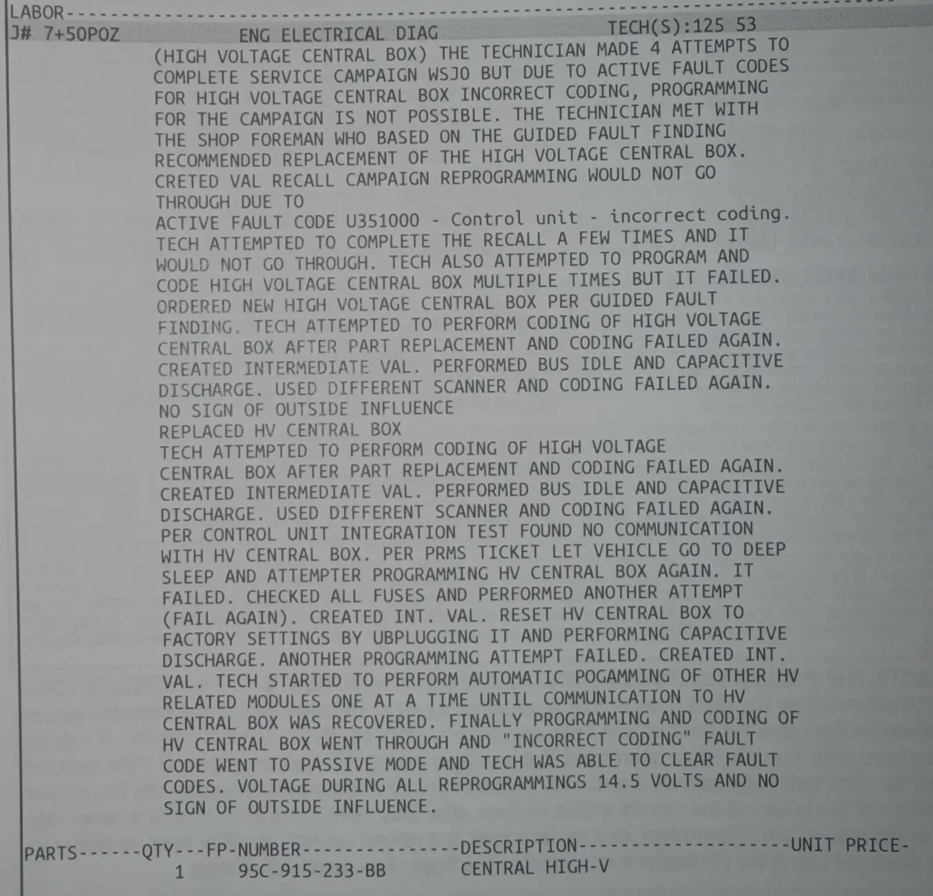

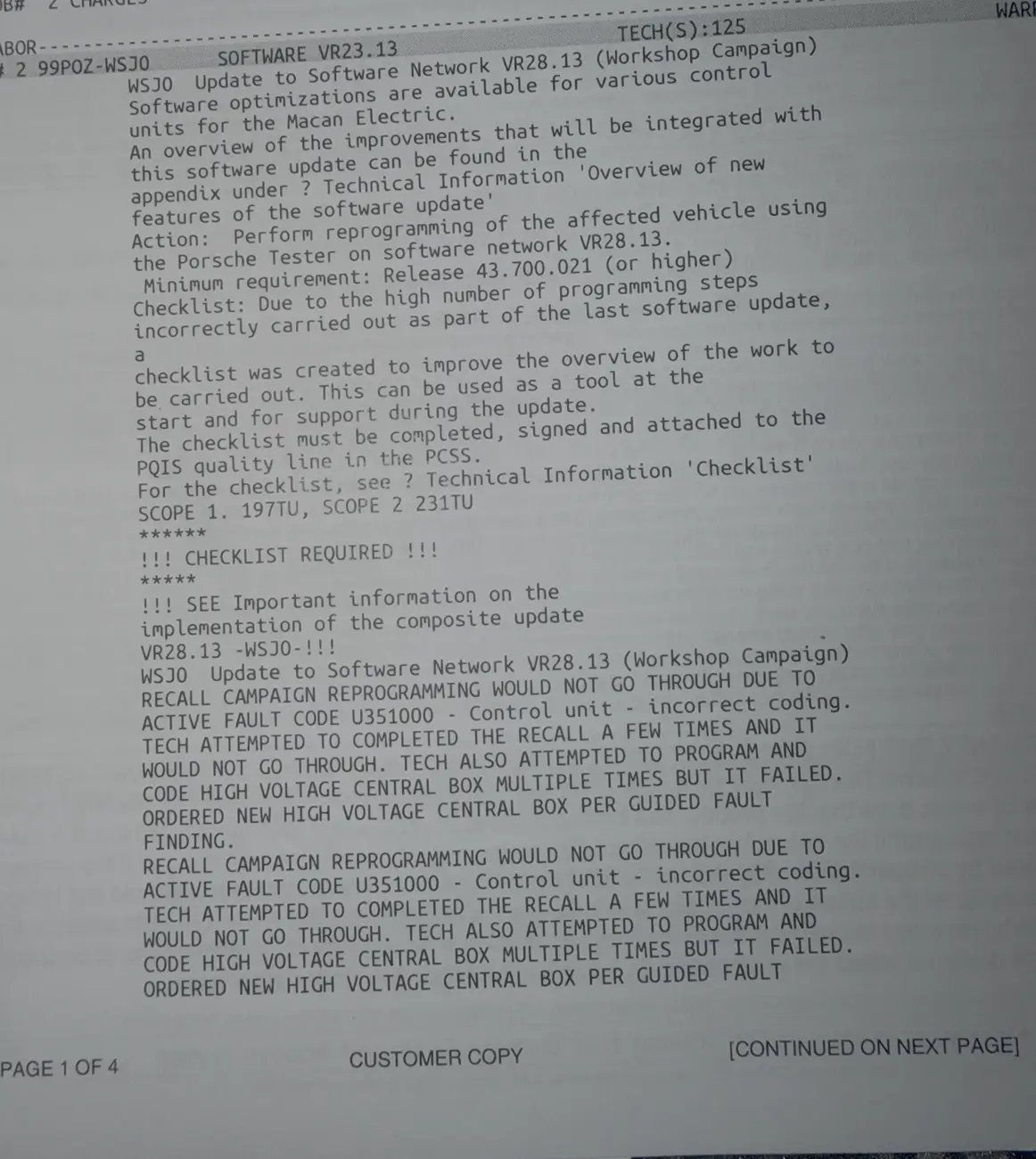

I finally got my car back after over a month at service, the HVC module had to be replaced and reset along with reprograming stuff including the keys...
Very disappointing that this is what it take to get this car to the latest software, at least it was done under warranty.
