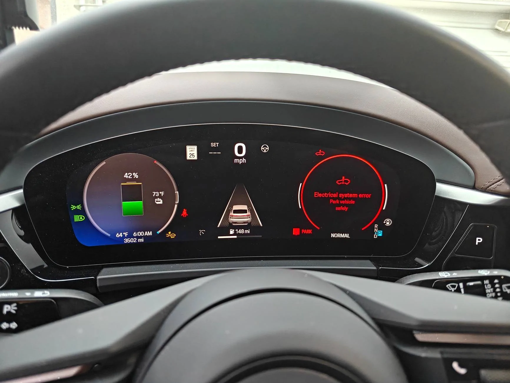

Good day to all. I received the warning below (similar to the Microsoft 'Blue Screen of Death') this morning.
After turning the car off and back on, the message went away.
My service people at the local Porsche dealer advised me that unless it reoccurs, don't bring it in.
So... Anyone experience this? Any advice?
Much thanks.

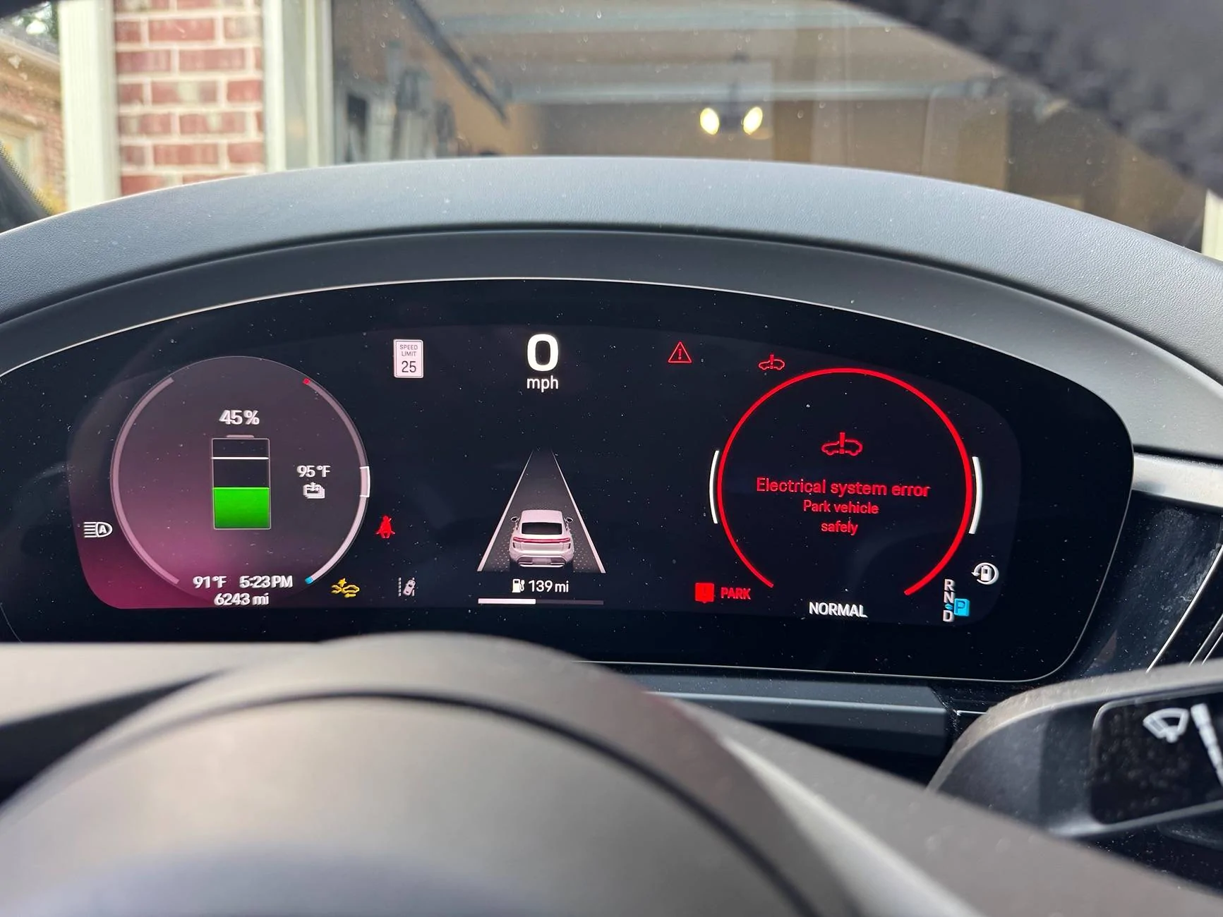

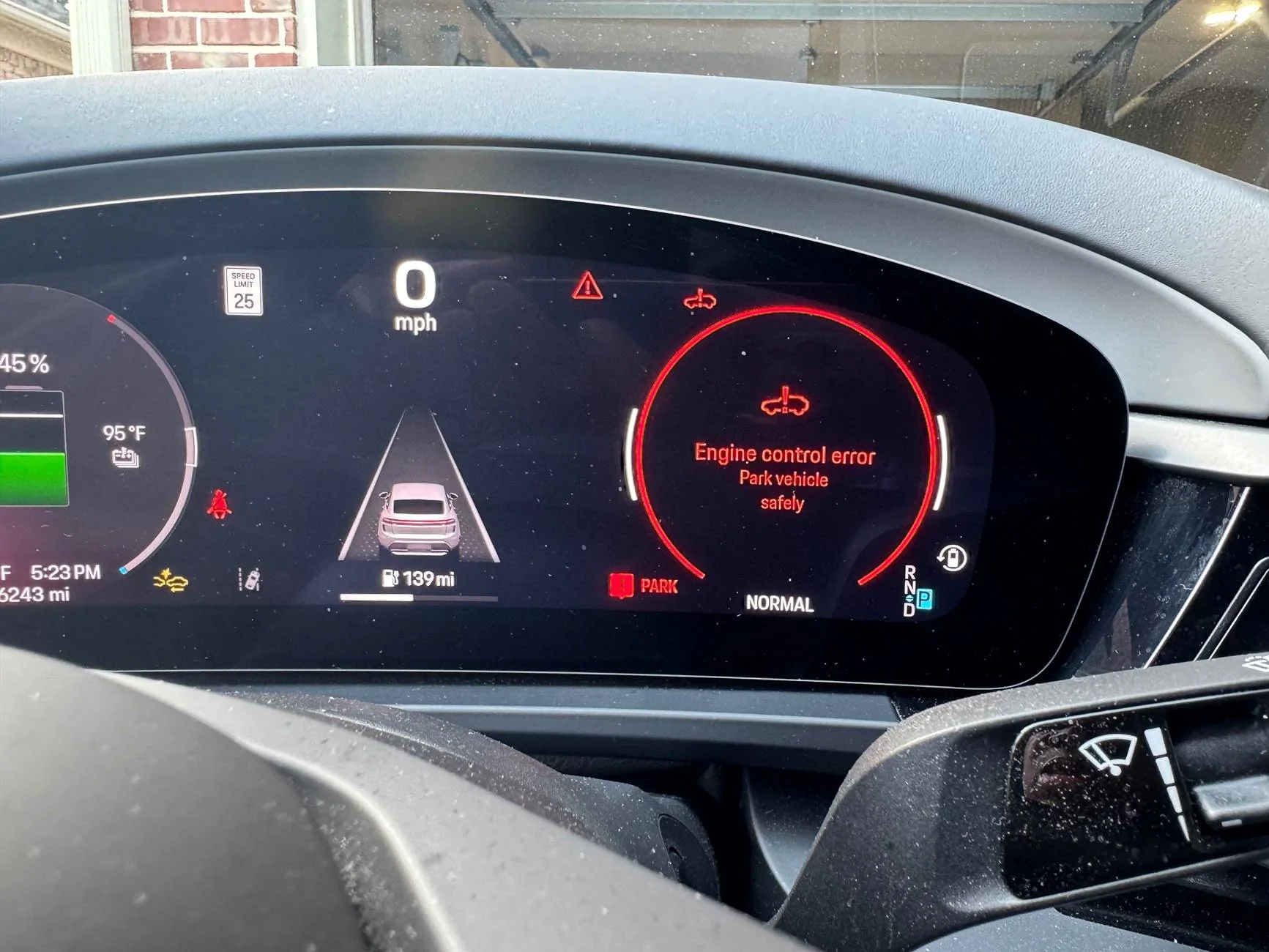

Much thanks.
I had this same warning happen the first week of ownership and car would not start after I drive it work that morning. Had to be towed 😒. Had to escalate with ticket placed for Porsche to assist as local dealer (Cleveland) had not seen this before. Ultimately replaced the
front end power electronics unit, Electronics control unit body front section. all has been well since 3 weeks.
