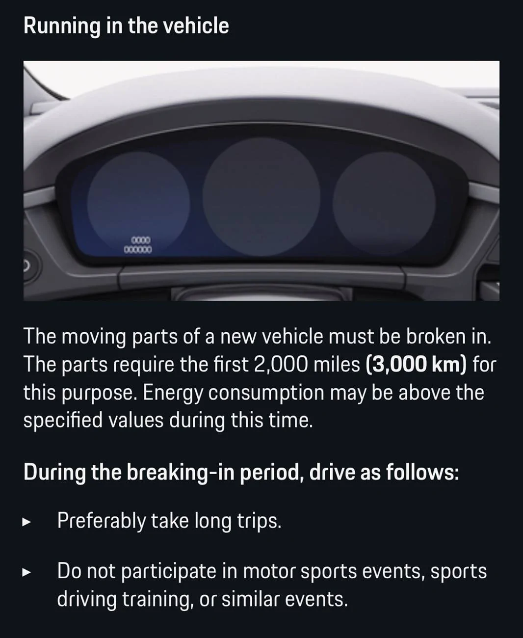

Also, if you’re not aware, there’s a startup period during which there’s no regenerative braking. This is so the mechanical brakes can be properly bedded. It will definitely affect your range.
How long is the startup period?

Note: after 600km the range improves a lot(!) I read that regen only started at 600km but I felt some regen so I thought it was a rumour, but today I did avg 17.3kw/h driving normally… I estimate an improve of 3kw/h. Lets see the next days…

A little confused does the Regen start at 600 km or 3000? 3000 seems like a awful long time (as a city driver that is)

On my experience I had low regen from delivery to around 250 km. A little more from 250 to 600 and now (I had to brake hard tonight and I have around 1050 km on my car) I have a lot of regen (based on the main display counter clock green graphics). You can feel when the regen end and the brakes start to work but it's very smooth.

Regen starts well before 3k KM. The 3 KM is the overall recommended break in, that no one abides by anyway and is mostly irrelevant for electric cars.
Regen should be fully active well before 1,000 km.
