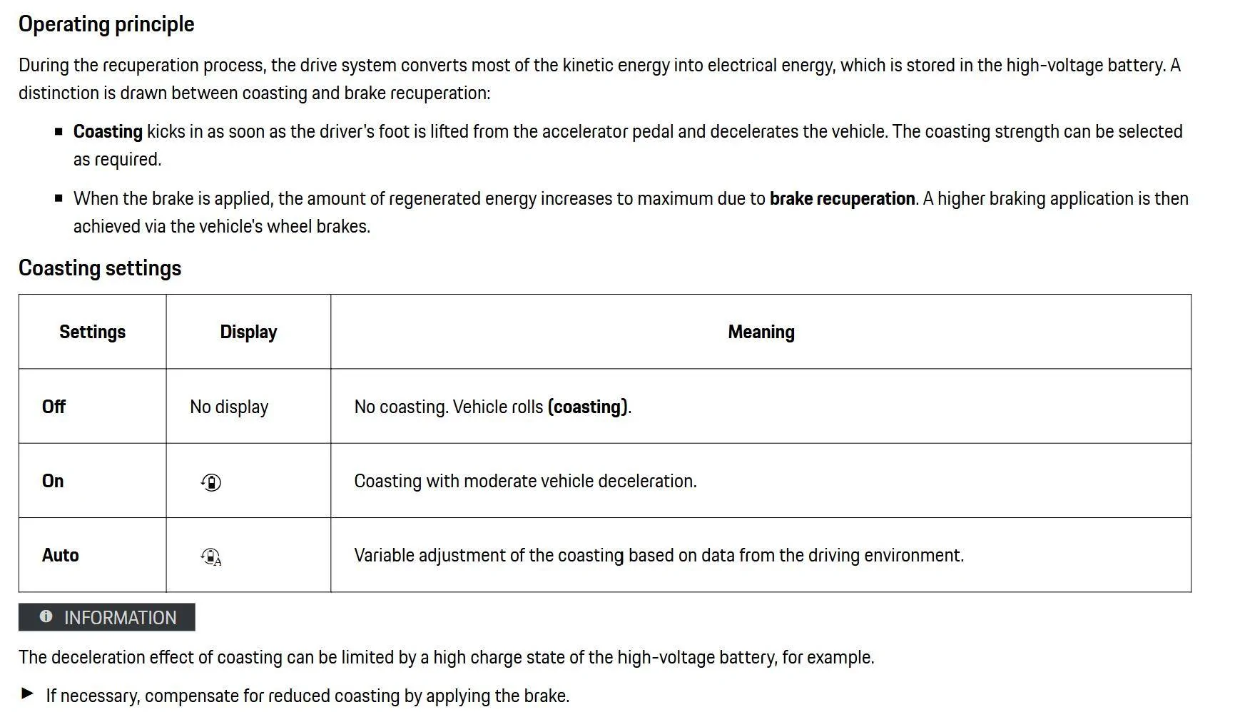

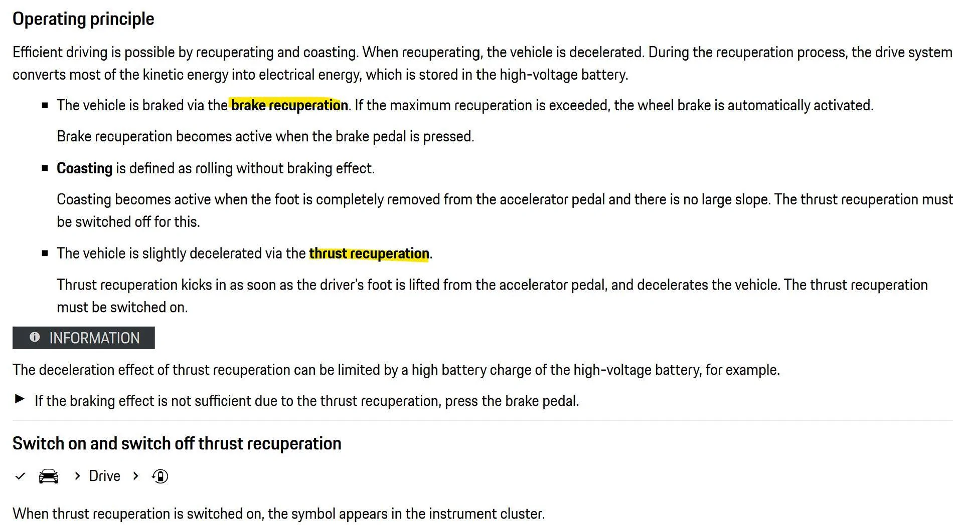

Here is what it says regarding Recuperation management feature in the online manual that can be adjusted by the driver. It is understood that these features are in addition to the always on dynamic recuperation management behind the scenes that cannot be controlled by the driver.
Macan EV uses new terminology: Thrust Recuperation.
This confirms to me that there is no Auto Recuperation feature for Macan EV.
Mystery solved. See feature description clips from both manuals below.
Macan EV settings:
Electric Macan EV Regeneration / Regenerative Braking in Macan EV? 1726276767484-f1
Taycan Settings:
Note that there is a misprint in the Meaning section, so this is my translation from real world use:
Off = Coasting when no significant slope
On = Recuperation* is On giving extra deceleration when accelerator is not pressed
Auto = Recuperation* is Dynamic to keep distance from vehicle in front
*Recuperation is only possible if the battery has capacity to store the extra energy
