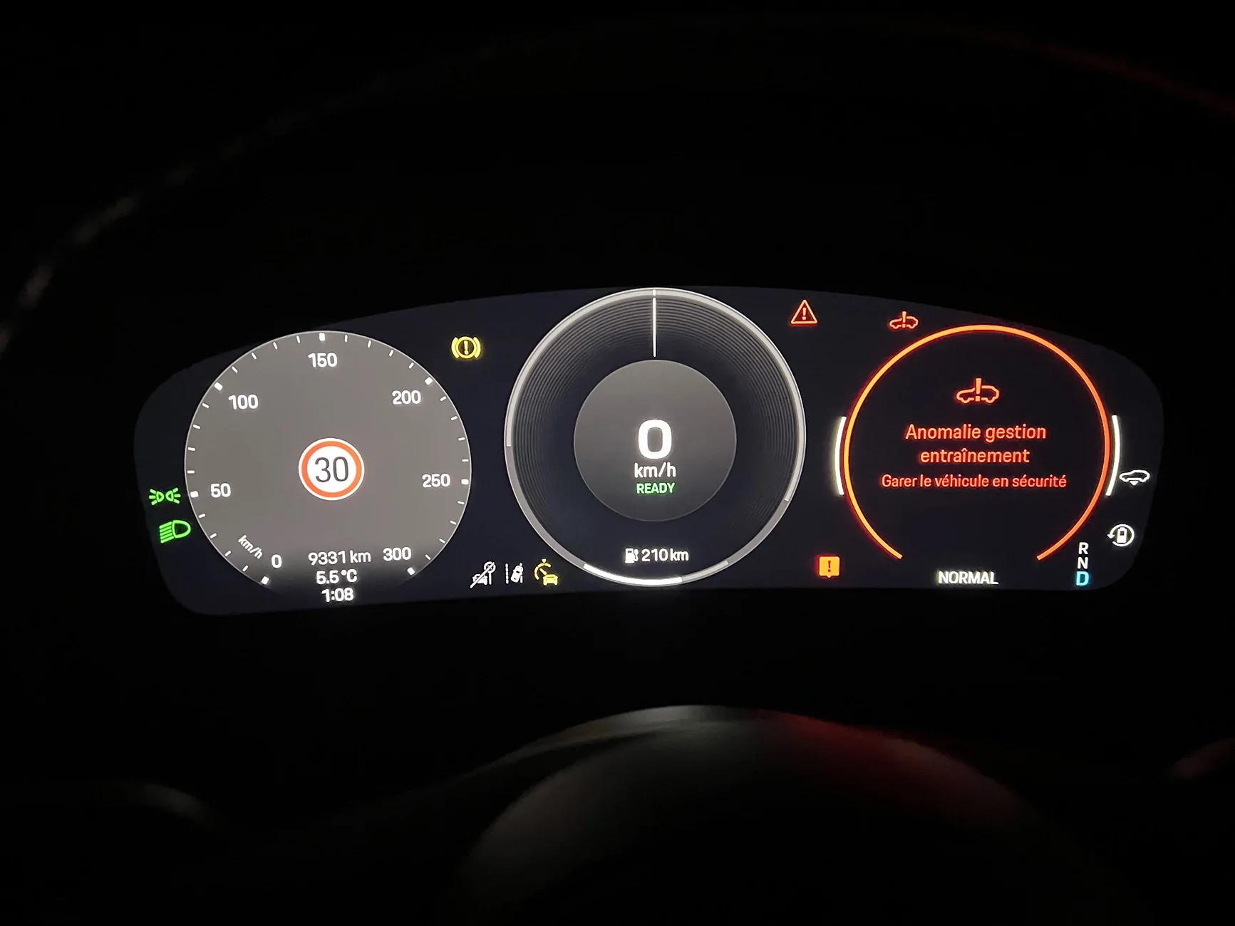

I spoke too soon. Got this one today. Dealer claimed they haven’t seen that before and would like the car back to investigate. What’s the bet it will be gone next time I go out? I’m not enjoying this new software update.
Just noticing this thread, but I have had the same faults as you, from the very beginning. Each time they download the error messages, they say they're inactive. And each time it's over 100 errors. In November of last year, they were hoping the software update would fix all my gremlins, but instead they broke my at home AC charging. I'm glad that after 4 months, they "finally" fixed my at home AC charging with a downgrade of the software (god why didn't they think of that earlier?!). I've had issues with CarPlay not connecting, sometimes for days as well. Dealer's adviser made a comment about how I'm more sensitive to these errors, some people don't care about them as much. I was floored by her comment. This high voltage system fault should worry most drivers I would think. Why would anyone ignore it? I've even had a red critical one pop up as I was backing up into a parking spot, but I couldn't get my phone quick enough to take a photo of it before it disappeared. Anyway, Porsche is losing a lot of owner's faith in their cars due to their software issues. I hope they get their acts together and start catching up.
FWIW I think I may be joining the ā€œsome people don’t care as muchā€ club. I had one of these errors the other day and simply stopped, switched the car off and on to make it go away and carried on. Maybe it’s the quality of the drive that keeps me going! The errors are fewer and farther between than they were before I had the latest SW upgrade. Sounds ridiculous when I write it down, I know, but none of these problems have actually stopped me from being able to use the car (yet).

i've been a Porsche victim now since my first 2008 911 4S - I've learned it's not a real fault unless it persist's for a few restarts/days…
unless it's a serious fault that is clearing impacting the vechicle's operational status - I ignore "warnings" unless they persist…
most of the time they go away and I simply note them for the next normal service…

Oh my...what happens if by ignoring these errors something does happen mid drive, on a highway or somewhere difficult to pull over? I had a friend who owned a Taycan, and his car died in the middle of the highway. Battery literally died on him and the car shut down. Porsche has trained you well šŸ˜‚
615
532
there are 3 warning colors: white, yellow and red. i have 2 macan ev(one is a turbo the other a 4s) we have never seen a red warning. we own the cars for one year.
only red requires to visit (drive to) the shop.
and: ā€œI have a friend thatā€¦ā€ said this and that haha.
other cars ā€œdieā€ on highways too. no?
