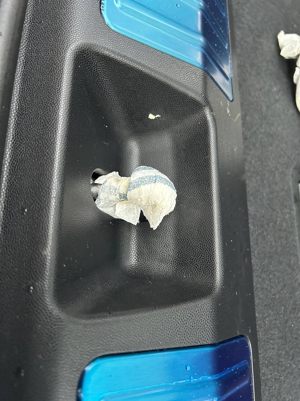

i had the problem, someone provided a solution, which worked. You will see from the photo below there is kitchen towel wrapped around the latch. It stopped rattiing. Simple, so it seems that i am not confused, its not non sensical and i have a macan 4 ev thats 1 month old. Clown

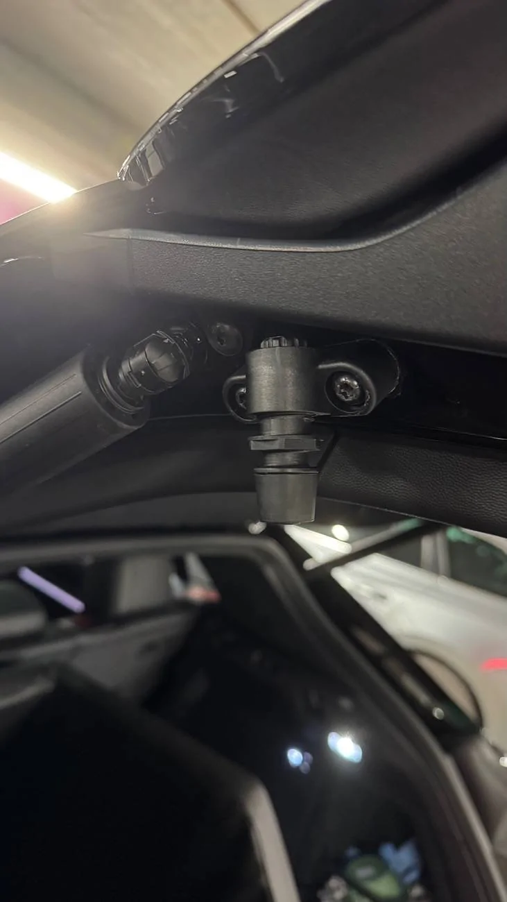

I think I’ve figured it out. I turned the 2 “distance holders” (or what you call them) a bit counter clockwise wise so they stick out more and prevent the trunk from moving metal on metal.
i also had that rattle when the temps got colder. The last two days I heard nothing so it might have fixed it. To be confirmed. Attached a picture.

i was told the same, have you not seen my photos of the temp fix?? It was the latch on the trunk. Just pack it out, stopped straight away.
