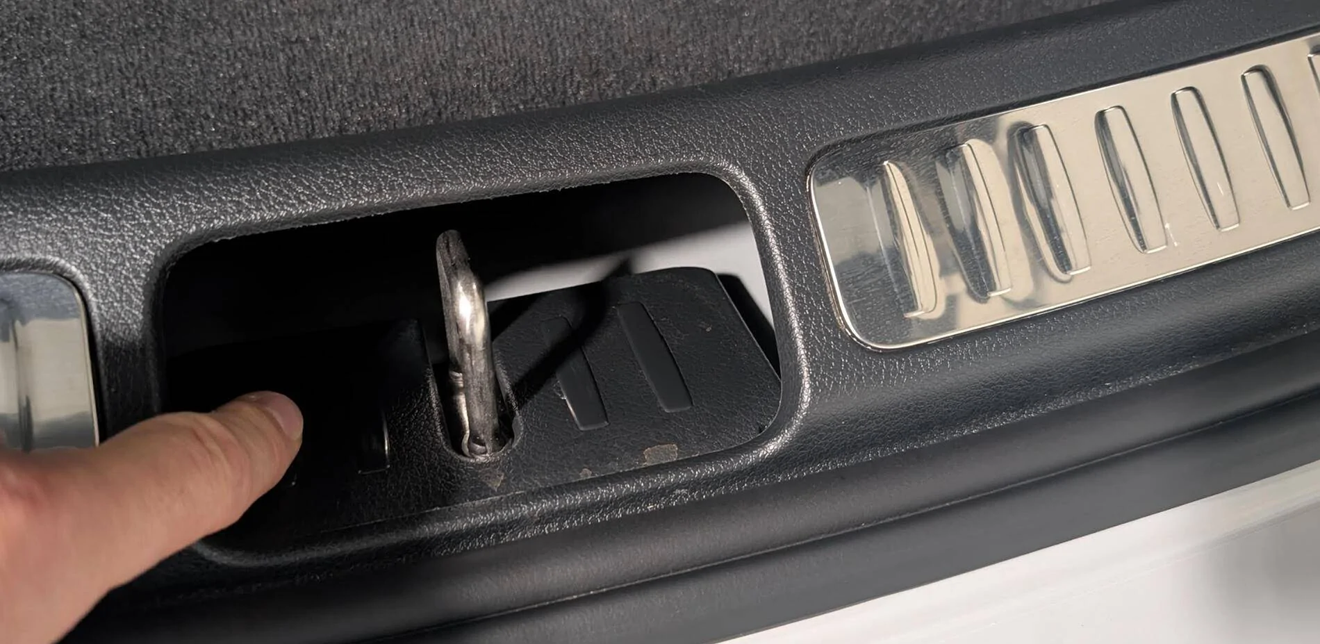

Hmm..I’m not seeing a latch where the hatch hook meets the loop. Can someone post a picture?
406
398
I am happy to help. Ideally, this needs to be someone with Macan EV, I do not have one, so the pictures are from Macan ICE but the mechanism is the same.
This is the flapper when it is up.
Electric Macan EV Annoying rattle/knock when going over bumpy road 1733357382738-yd
You can push it down like this. The fix is to put foam under it.

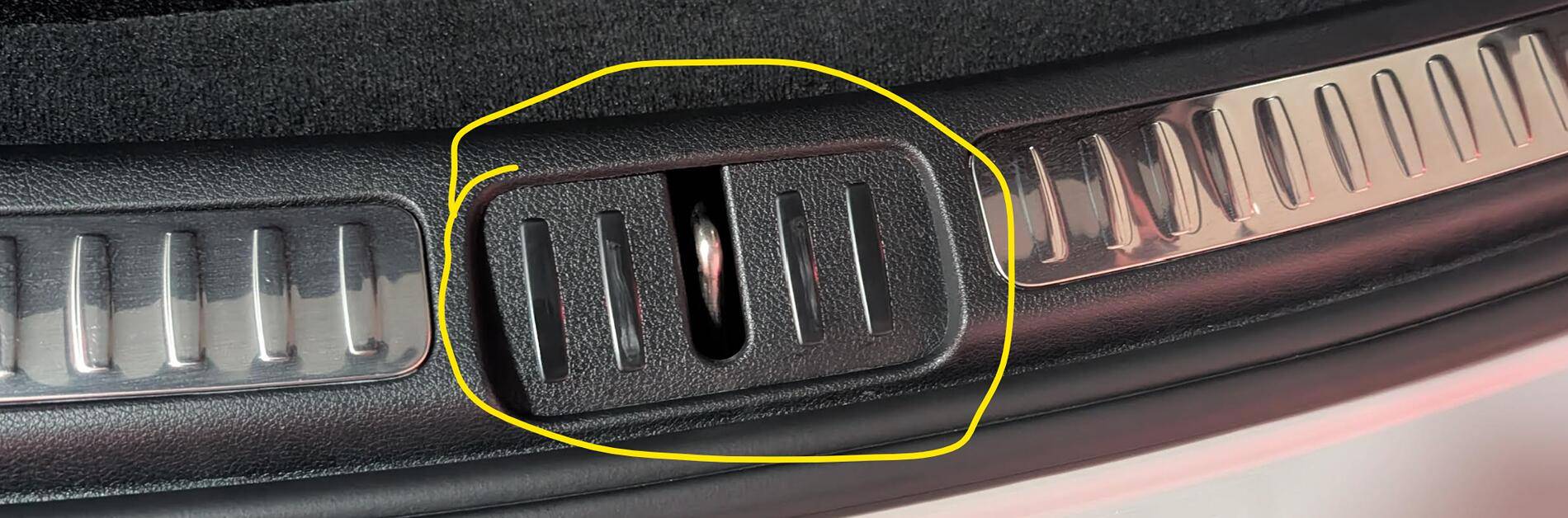

i’m confused. I have the same annoying sound, but I don’t have a flap in that area. Any insight from the Macan EV owner who fixed it with paper towels?
Mine looks like this:

You beat me to it. I was going to post the same picture as mine also does not have a "flap." Not sure what the previous poster meant by saying he fixed his.

I only had Macan EV loaner for a day and pretty sure it had the flap as I am showing, but again someone with the Macan EV needs to help out here.

The picture is from a Macan EV. Matches my Macan EV Turbo

same here, no flap in EU.

No flap here neither…
