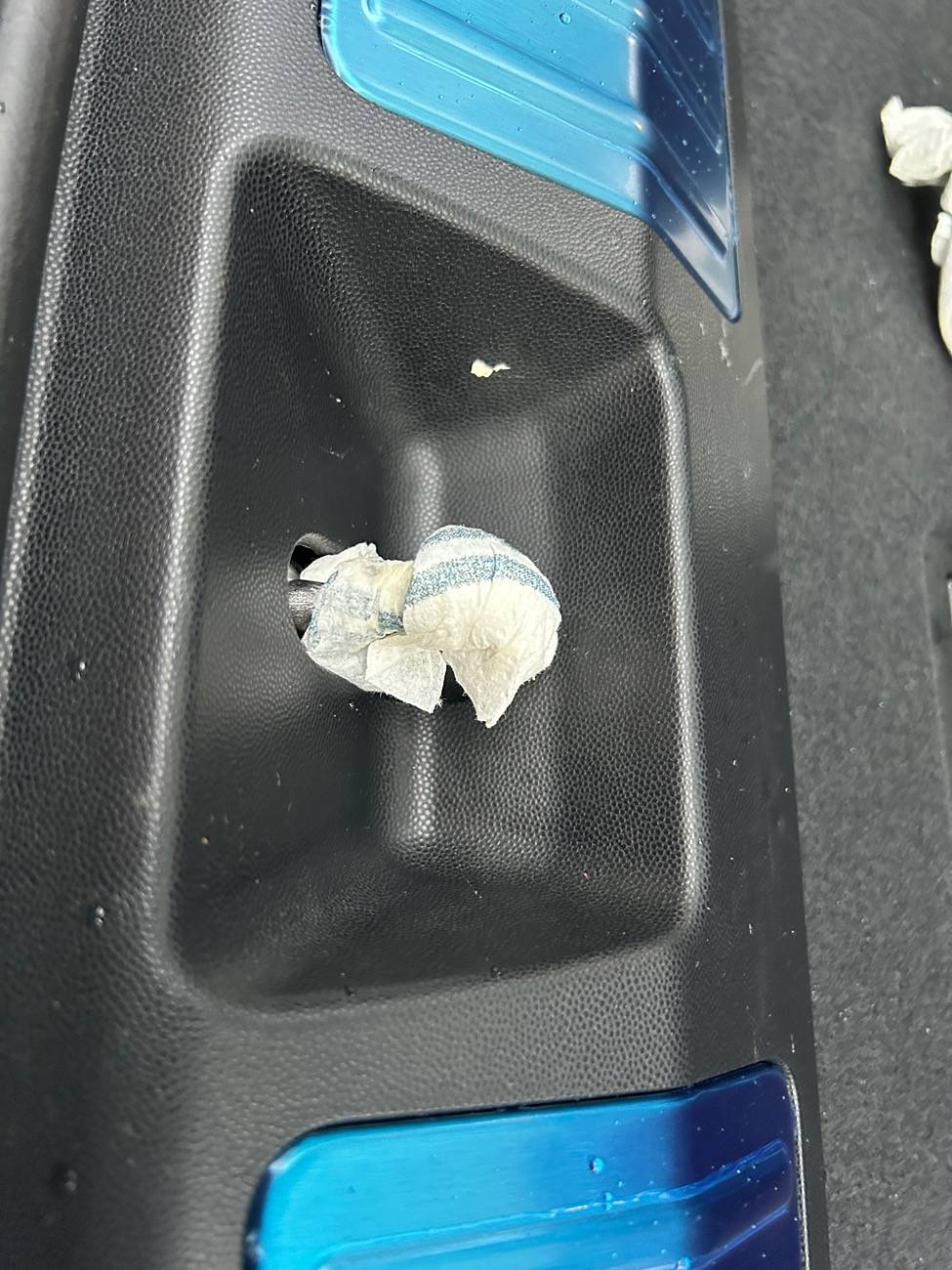

Ok i will send a pic later but i have wrapped everything in kitchen roll so see what happened. This has provided a solution to stop the rattle.
The picture wont help as it looks awful.
The porsche centre have said they will replace the whole thing next week so will uodate then.

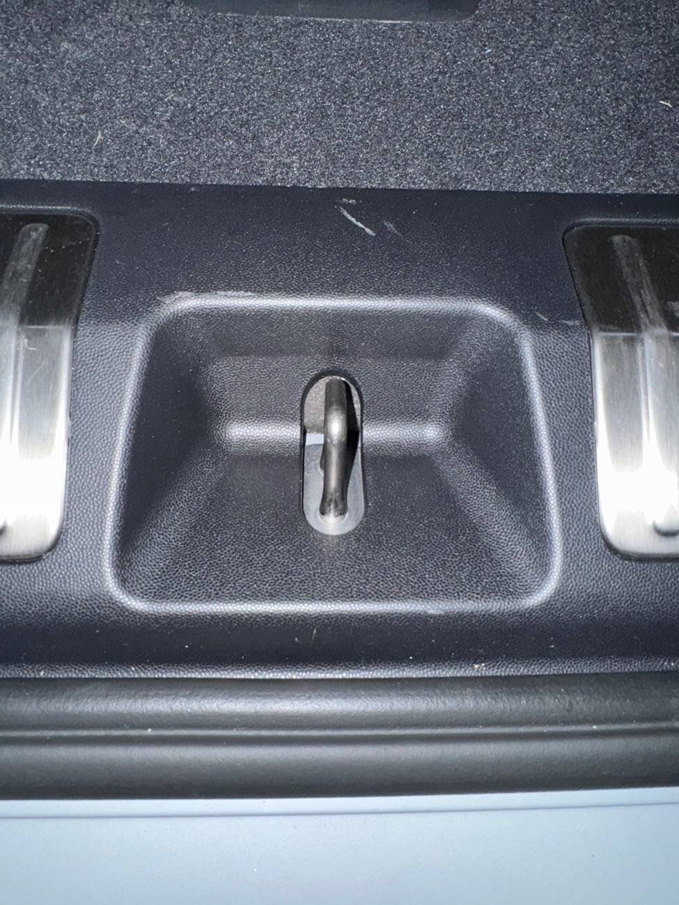

Mine looks like this:
Lubricate the metal part…it’s not rocket science!

I think the OP created a fictional "solution" or is just massively confused. Description of the fix is non-sensical as there is no flap anywhere near the loop in a Macan, unwilling to provide a photo and non-sensical reason as to why, brand new member with no other posts. Are you sure you're talking about a Macan EV and not some other car??

Asked to my SA if any "new" version o specific market has the flap, he asked the tech area in Germany and there's no flap on the Macan family (by default).

same here, no flap in EU.

I just wrapped some kitchen towel around the ‘loop’ part of the bracket and that stopped the knock/rattle.
Its going to the dealer to sort properly next week

i had the problem, someone provided a solution, which worked. You will see from the photo below there is kitchen towel wrapped around the latch. It stopped rattiing. Simple, so it seems that i am not confused, its not non sensical and i have a macan 4 ev thats 1 month old. Clown

This is a photo of my simple fix that was more of an attempt to see if this was the issue as opposed to a long term solution. I just wrapped some paper towel around the latch on the bottom of the boot, also there is definately no flap. The car is back with the dealer on tues to resolve properly.

See below, i just wrapped a paper towel around that latch. Not sure what all the ‘flap’ talk is about as there isnt one.
This was just a quick idea to see if it helped, and it has resolved the probelm. Its back at the Porsche centre this week to get a proper fix. Give it a try, the noise was driving me nuts so this was just an amazing difference.

Did you see the fix suggetsed about the latch. I pit some kitchen towel around it to see if that stopped it, it did. Not a oong terms solution but helped idetify the problem. See pic
Thank you for sharing!! I’ve forwarded this to my SA. My car is at the dealer now to have this looked into (as well as the fact that both the batteries in my key fobs have died twice within 2 months of owning the car!!).
