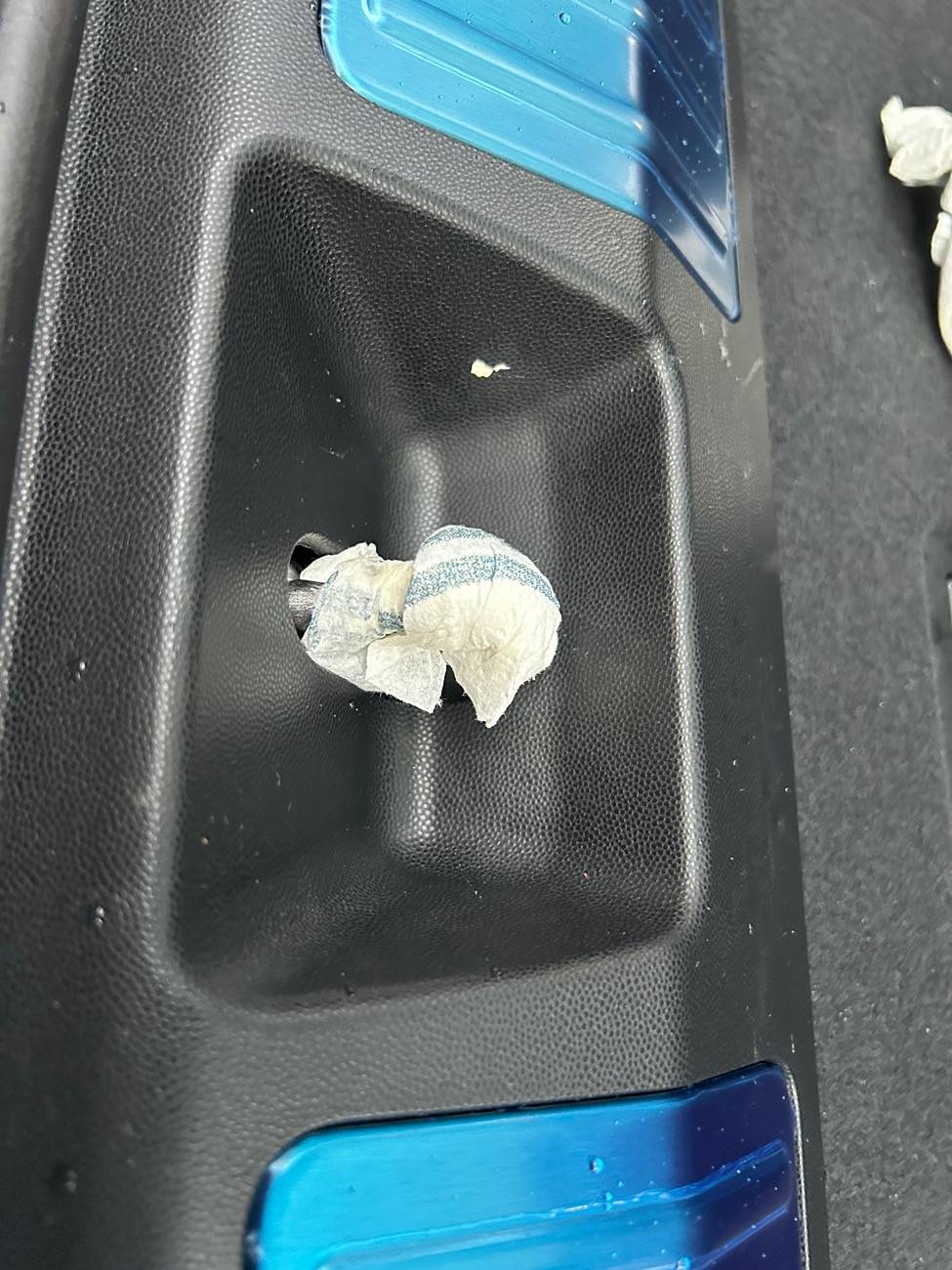

Please see my previous answers about what the problem was. It is the latch rattling around. Still waiting for the dealer to sort, but packing out the latch has saved my sanity in the short term

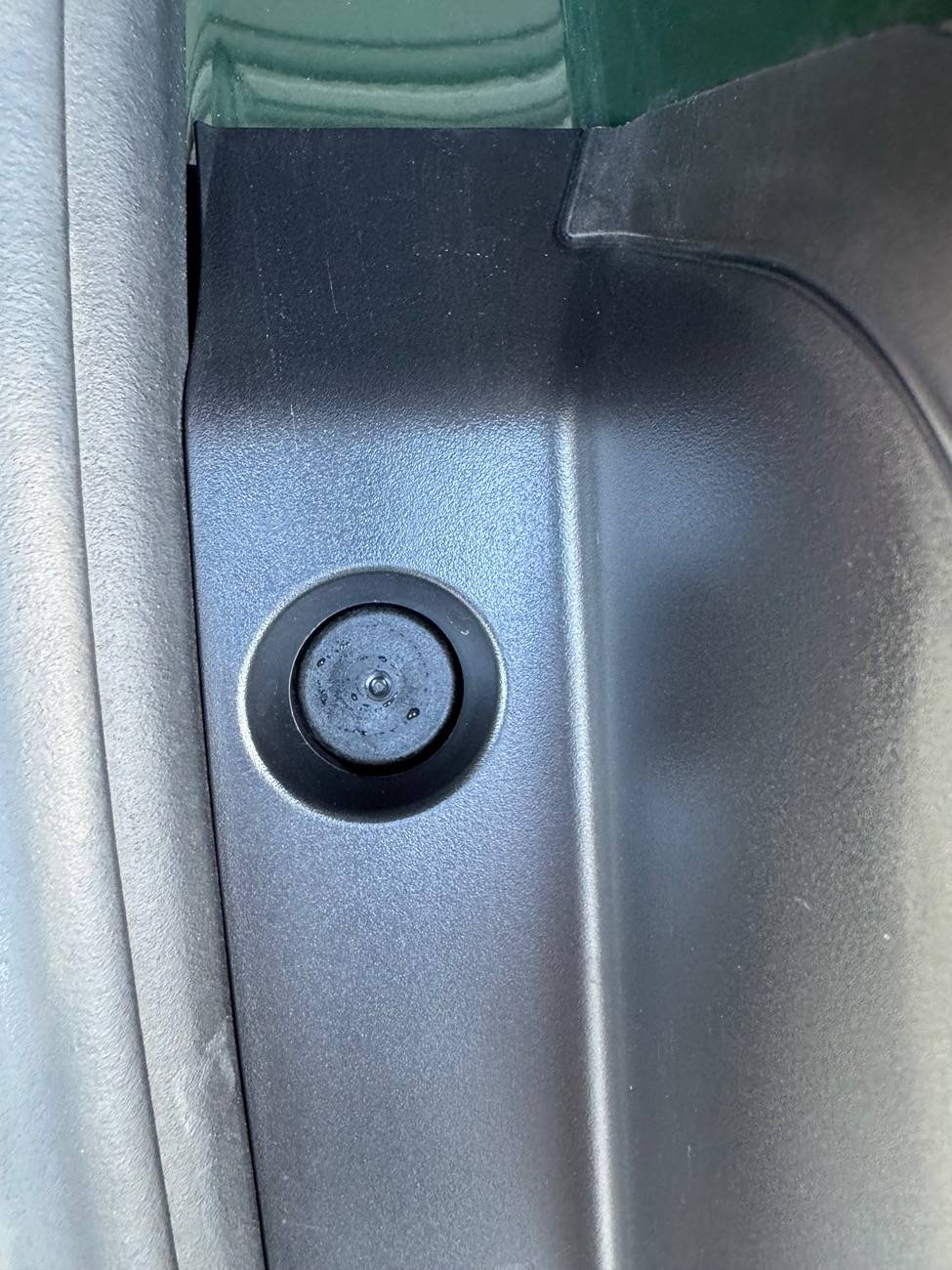

Guys,I think there's a great chance the solutions described by both @ppcarter1 and @Jetced be related.When the 2 so called “distance holders”/regulators are extended won't allow the locking latch mechanism become loose, hence the rattle noise.When the hole trunk door locking is stiffened extending the 2 regulators the rattle stops.By wrapping the latch you get exactly to the same point
Seems quite logical to me. 😉
Do you have to pack it like that every time you open and close the tailgate or does the wrap somehow stay in place?
Its just kitchen towel tightly wrapped around the metal.
My trunk lid was rattling also. I unscrewed the black stoppers as far as they would go without falling out on both sides. This solved my rattle.

Adjusting the distance holder works. But I had to unscrew both of them pretty far out. I unscrewed each completely out first, then screwed them back in a couple of turns and that finally killed the rattle. Your mileage may vary.

i also have removed the parcel shelf. I have extended the distance holder as far as possible and wrapped insulation tape around the metal bracket. No rattle at all now

Could you attach a photo here with the insulation tape, with which I assume you replaced the paper towel. Thanks man!
I will try and play with my distance holders again like yours; what do you mean by "your mileage may vary"?
I simply meant that how much or little you screw them back in may be different for your car. For me, I found two turns to be perfect, and I've not had any issues since then.
Gotcha! We tried adjusting the distance holders several times in different ways, but have not unscrewed them very far out yet, worrying that might affect how the trunk lid closes. So the rattle noise has only got better but not disappeared yet. Thanks for the tip!
Yeah, I was concerned they might fall out, but I was able to do 2 turns and they are secure. Saved me a trip to the dealer. I'm guessing at some point they may do something that's a better fix, but for me, I stopped thinking about it now.
