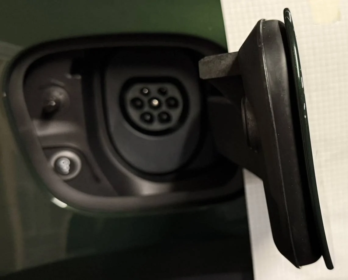

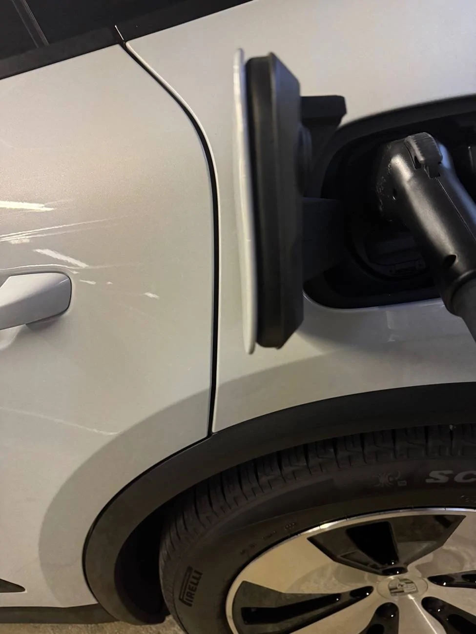

This is unacceptable quality issue on a Porsche coming out of a German factory. I just got a Macan RWD for a day and looking in the rear view mirror, the manual flap is not flush.
This is not acceptable on the passenger side flap. The other side was flush.
This is not a Tiguan after all, where they pull this kind of stuff all day long.

We need to keep this thread going as this should not be happening and hopefully anyone who got it fixed can share what was the solution.

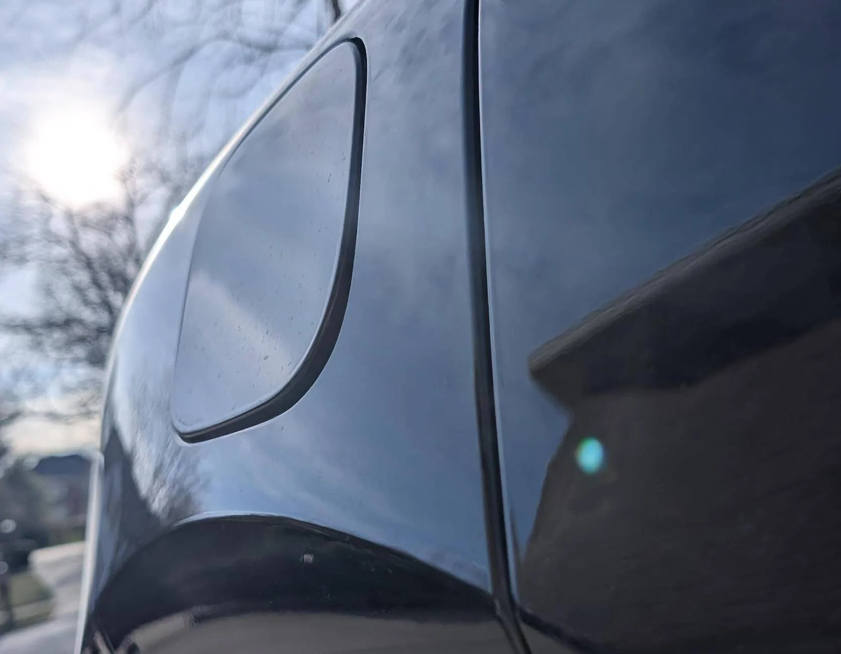

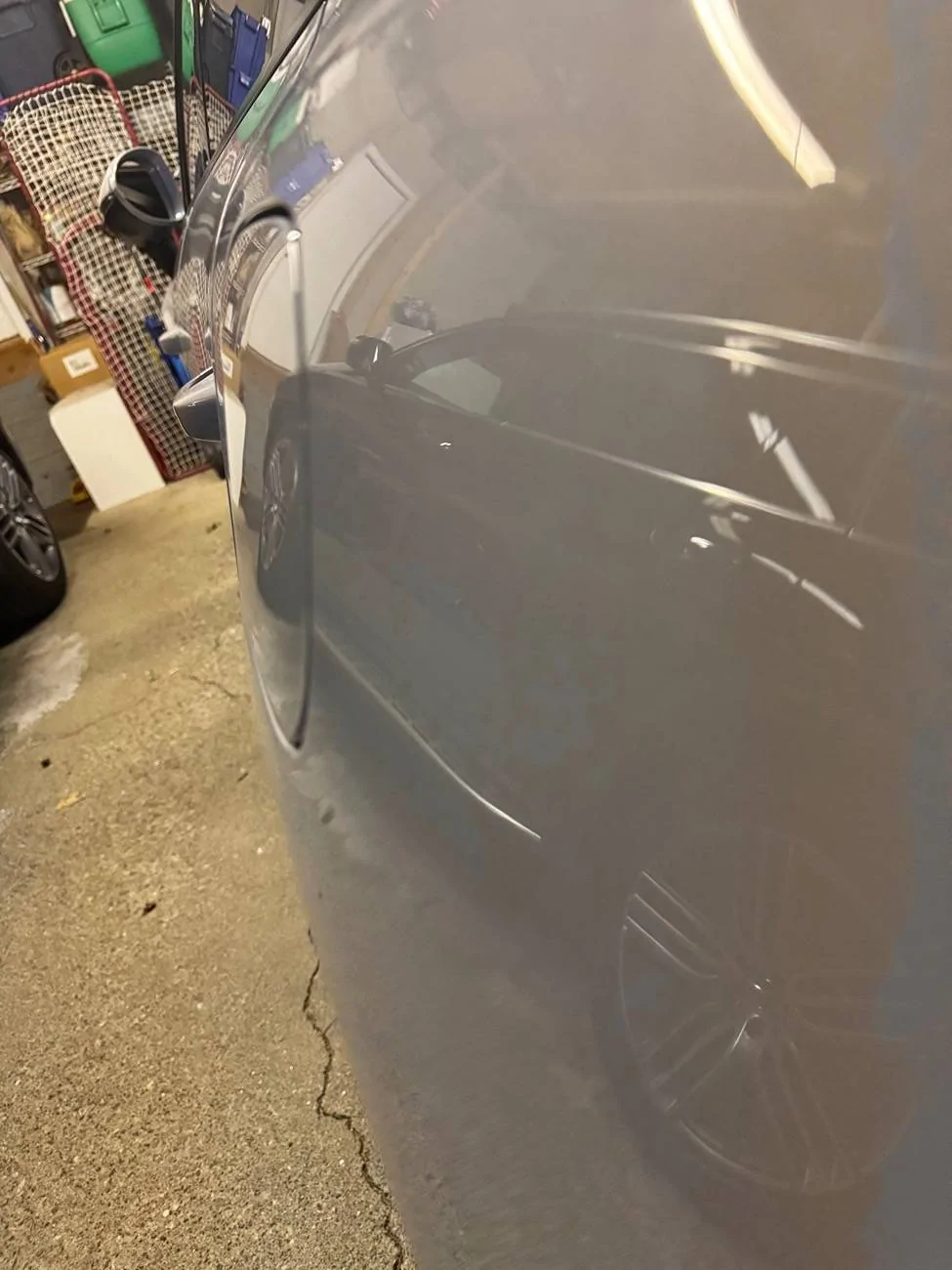

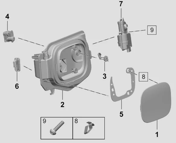

It would be good to get a comparison with your fixed door - does it also have the flare out at the bottom and the concave dishing that I see on my car?
Also - which part was adjusted on the door mechanism (see the parts diagram) - did the clips [8] get changed somehow or just the hinge?

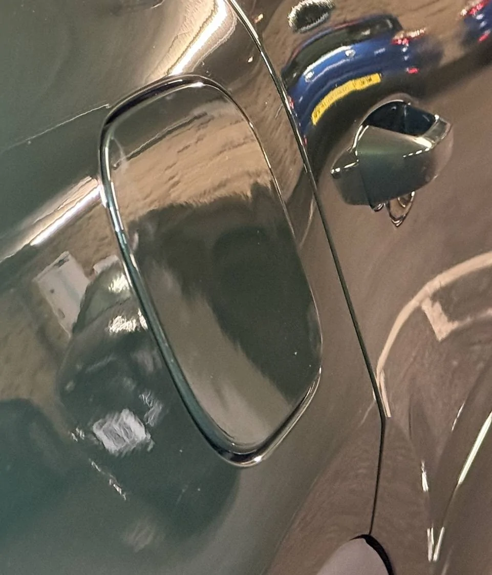

Mine looked like yours before they fixed it. I wasn’t paying close attention to what he did, was taking to my SA. But I can say he only used a screwdriver of some kind and didn’t replace or remove anything.
So my SA and the dealer’s GM were ready to put in a claim with PCNA when they decide to show the service manager who laughed and said, “I got this”.
