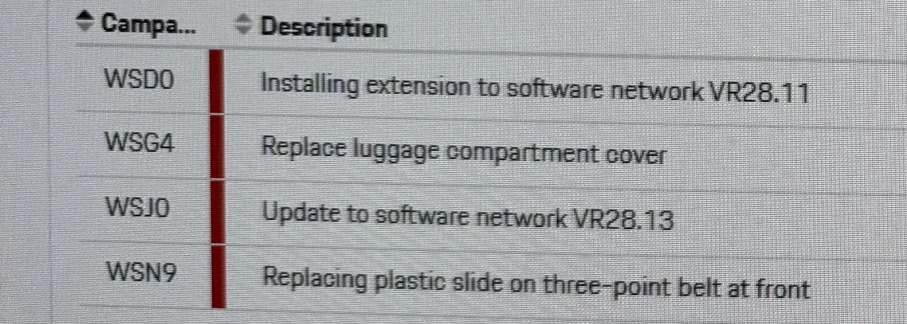

So I've just left my car for previously scheduled maintenance and dealer confirmed this new update is available.
It's WSJ0 campaign and it upgrades software to VR28.13. Takes a couple of hours and affects a lot of onboard systems. My car should be ready be the end of this week, will let you know how it goes.

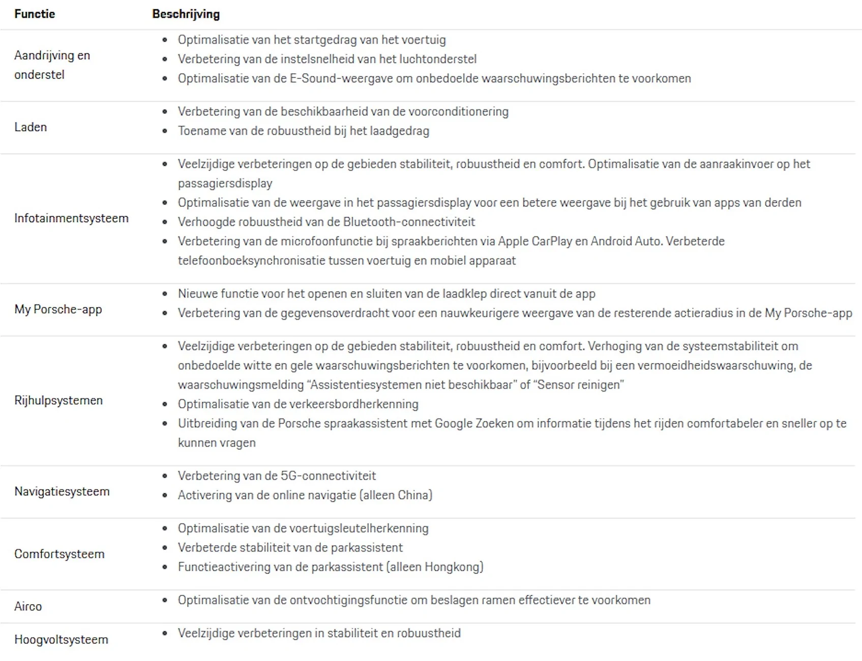

Little update; the dealer in The Netherlands has the update available. The version is v28.13! They tried to install it on my car yesterday, but the process stopped. They had to leave the car untouched overnight, and today PAG is watching in the background to see where it gets stuck.
I got a changelog with all the updates the version contains. It's in Dutch, so I asked ChatGPT to translate ;-)
FunctionDescription
Powertrain and chassis• Optimization of vehicle start-up behavior
• Improvement of chassis adjustment speed
• Optimization of E-Sound display to prevent unintended warning messages
Charging• Improvement of preconditioning availability
• Increased robustness during the charging process
Infotainment system• Various improvements in stability, robustness, and comfort. Optimization of touch input on the passenger display
• Optimization of the passenger display view for better display when using third-party apps
• Increased robustness of Bluetooth connectivity
• Improved microphone function for voice messages via Apple CarPlay and Android Auto. Improved phonebook synchronization between vehicle and mobile device
My Porsche app• New function for opening and closing the charging flap directly from the app
• Improved data transfer for more accurate display of the remaining range in the My Porsche app
Driver assistance systems• Various improvements in stability, robustness, and comfort. Increased system stability to prevent unintended white and yellow warning messages, for example, for fatigue warning, the warning message “Assistance systems temporarily unavailable” or “Clean sensor”
• Optimization of traffic sign recognition
• Extension of the Porsche voice assistant with Google Search to ask for information more comfortably and quickly while driving
Navigation system• Improvement of 5G connectivity
• Activation of online navigation (China only)
Comfort system• Optimization of vehicle key detection
• Improved stability of the parking assistant
• Activation of the parking assistant function (Hong Kong only)
Air conditioning• Optimization of the dehumidification function to prevent fogging on windows more effectively
High-voltage system• Various improvements in stability and robustness
Original doc in Dutch:

This actually looks like my scheduled work list. So please let me know how it goes.:)
Slightly OT - Besides the software update, does anyone know what the luggage cover (WSG4) item is about? Is it a new part?
As for vehicle software versioning (for control modules), I don’t know if there’s a way for us to check - suspect it would only be accessible via diagnostic tools.
So this scope confirms it's indeed the WSJ0 my dealer in Poland claimed is the "big update".
The list is extensive, hope it helps with a lot of issues reported here.
I'm optimistic, let's see how it goes.
This is the only campaign that had "scope: 2,1" and "with customer letter: yes" next to it, anyone knows what's that about?
