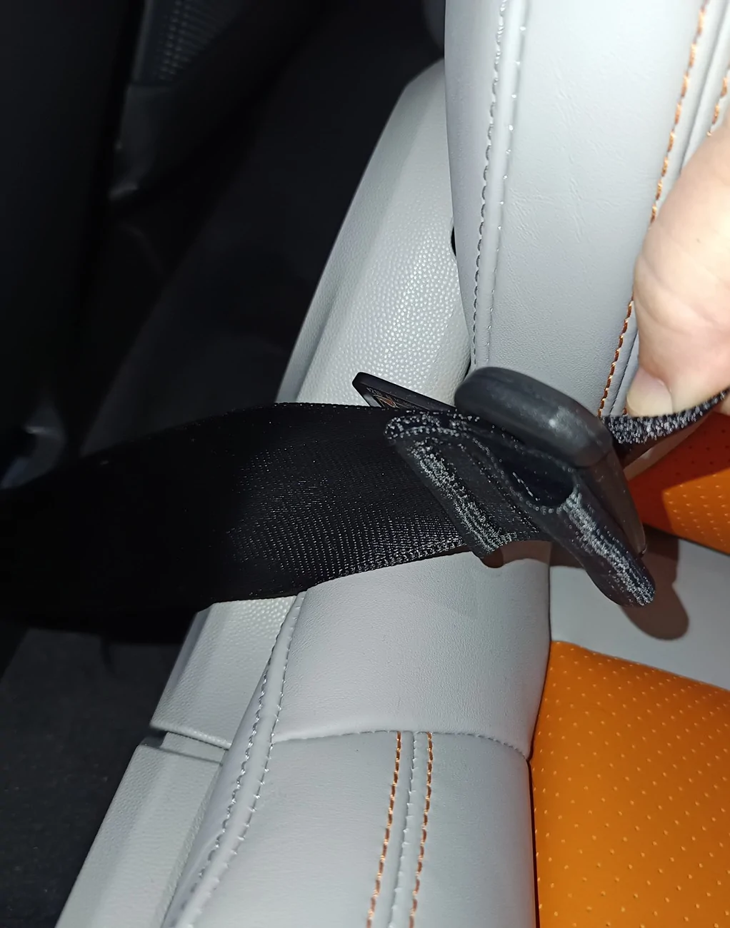

Concerning the seatbelts solution the dealerships fix the problem as per Porsche instructions admittedly looks awful, especially when colored seatbelts are involved.
My car however came out from the factory mid September with the issue solved in a more professional and proper way. Looks way better IMO.

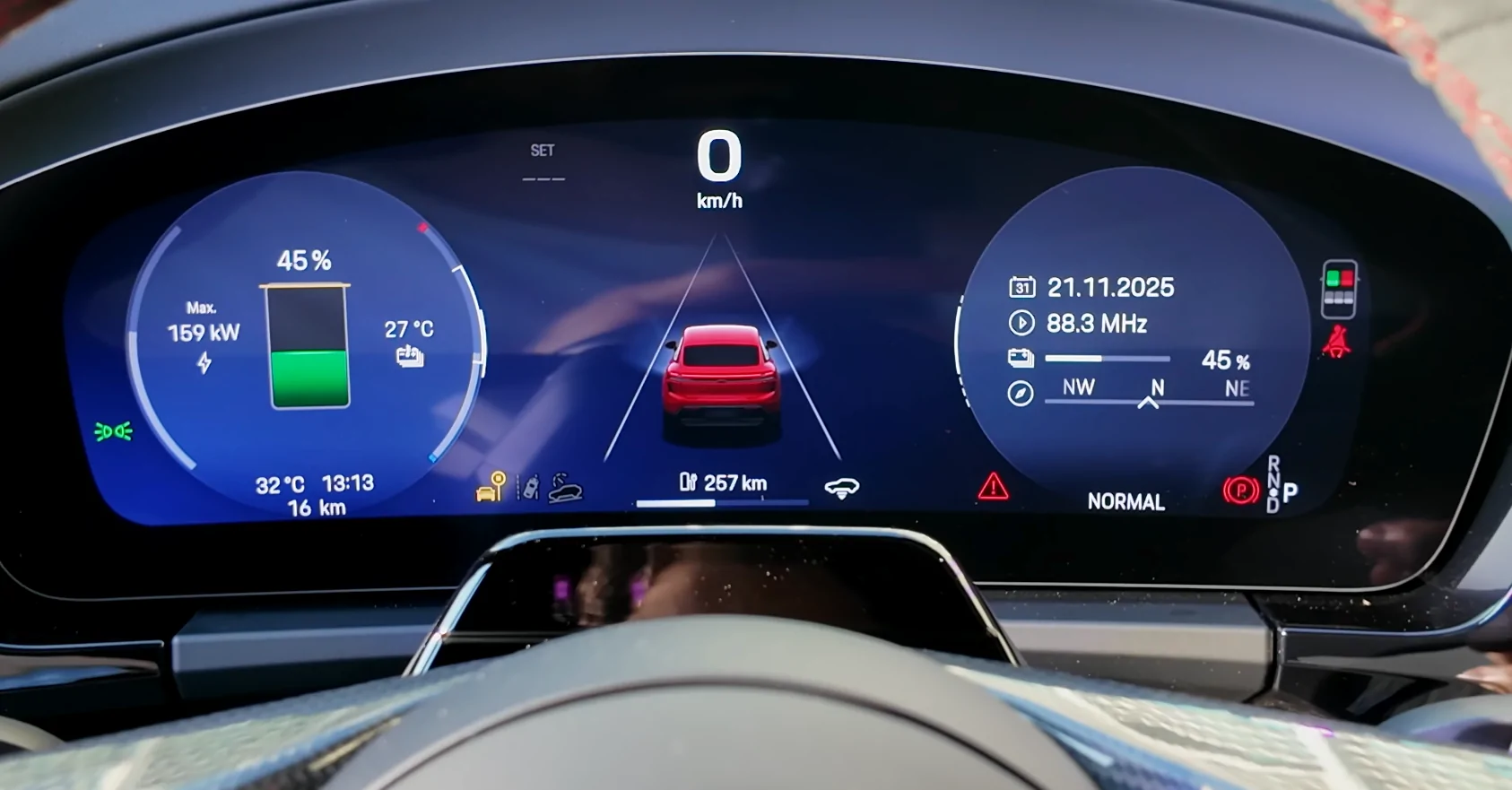

I've not had the update yet but something we've all been crying for was shown off today in an Autogefuhl video with the GTS model in Dubai.
  • Max DC charging power in PCM & cluster display (along with a slightly updated layout)
  • Correct colour & model of car shown in displays! (Actually, it's still wrong as it shows a Macan turbo in the first picture)
Can anyone with the update confirm this is NOT part of VR28.13? If so we can assume it will be coming at delivery of MY26.
I had this update done and confirm that none of what you see there is provided in the 28.13 update.
Thanks for posting the only acceptable solution, posted a picture of my VW about this many moons ago. Unfortunately some people are easily pleased and saying things like it doesn't look bad, works fine, etc. is what allowed Porsche to cheap out on 2024-2025 models by using this awful hack instead of replacing the 1 seatbelt with a VW/parts bin one.
