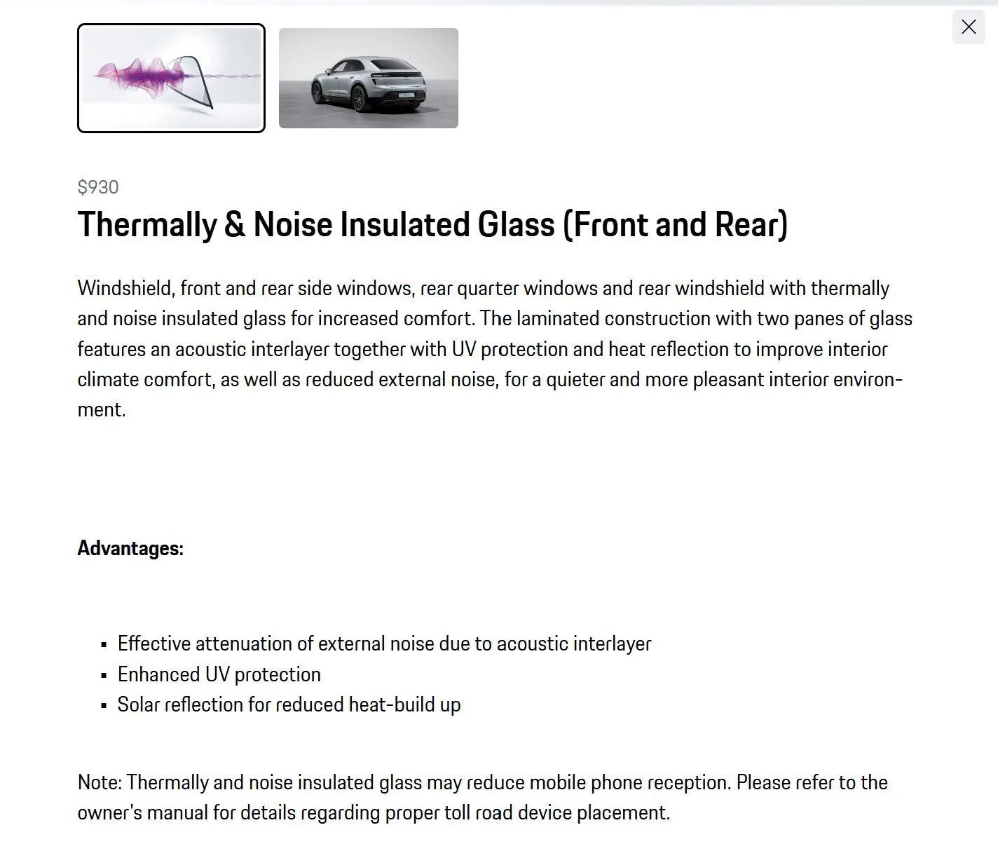

People do not seem fine with it on the Taycan forum. There are pros and cons to this option and for absolute clarity this is the option we are talking about below.
The biggest reason this would be a must have for me is because Macan windows are frameless just like Taycan, so standard glass is very thin and flimsy with doors open (on the Taycan), where this option makes the glass more substantial being double pane with inner layer in between. However, the downside is cell phone reception, although I have no issues, even after tinting all windows but front, and then having very thick front window protection film (Exoshield). Also, you have to place the toll road readers in a particular spot near the mirror.
Since Taycan has very large sunroof, I have not noticed much of heat protection, even on a mild day, interior getting hot pretty quickly, but having pre-conditioning option, makes it a non-issue for short stops or cooling the car down before a drive if standing outside in direct sun. Also, Taycan is so low to the ground and so quiet, I am not noticing any acoustic protection either, I can hear physical brakes at work, road noise on a local road or on a highway (all-season 21-inch tires), brake noises from other cars, or music from other cars.

Not sure I have any protection on my Modal 3 and it gets pretty bad inside without preconditioning. I drove a Q5 recently that had thermal and noise isolation and I could tell the difference for sure. Didn't have to drive with sunglasses that's for sure. But if you've never been in a car without this pack, then you will not miss it. ?

@SergeyIndy the OEM All-Season 21s on the Taycan are incredibly noisy, notoriously so. Going to 20s vastly improves the noise.
My 4S with 20s and no acoustic glass was slightly less noisy than my Turbo S with 21s & acoustic glass, while the Turbo S with 20s was quieter than the 4S.
All 3 were quiet, with the 21 inch tires on the Turbo S w acoustic glass being the most annoying sound any of the 3 iterations let in. fwiw.

A note about the Thermally and Noise Insulated Glass: it is stronger, thinner, and lighter than standard glass. The three plastic layers between two sheets of glass replace the weight of glass and are slightly thinner and lighter than the glass they replace. They also make the composite stronger than only glass. The downside is reduced cell phone signals, but we love it over standard glass, especially the heat reduction in the summer.
