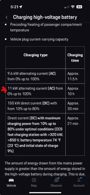

It's more than just the website; I just noticed this in the owner's manual:
Electric Macan EV [North American] - Macan does NOT support 11 kW charging??? Home / Residential charging update (using Tesla Universal Wall Charger) 11 k
this is very very helpful!!! 11 kW mentioned in the manual - wow - Porsche really screwed up this one!
