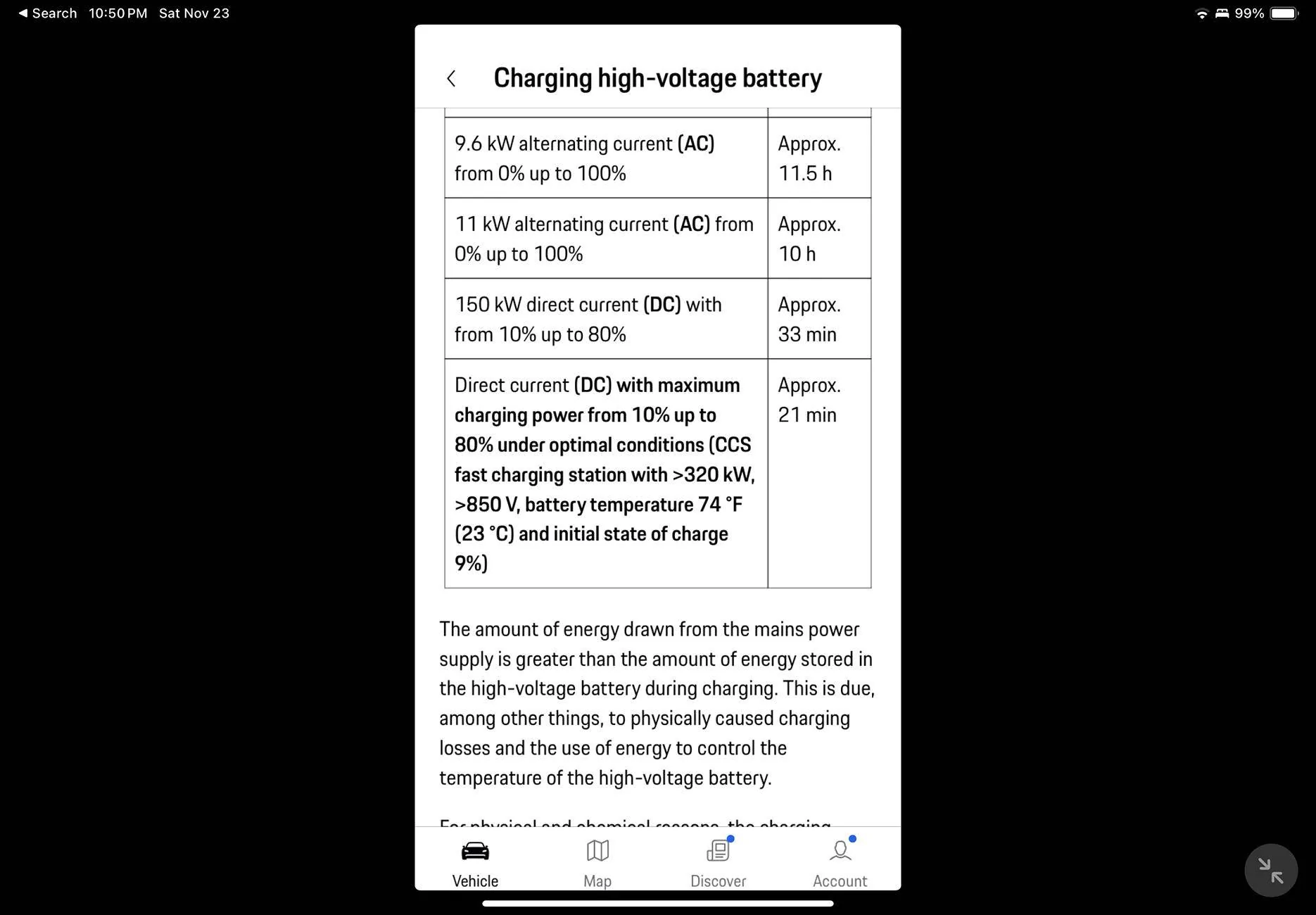

this is very very helpful!!! 11 kW mentioned in the manual - wow - Porsche really screwed up this one!
Now that I read this more carefully (and note the comments about charging overhead below the chart): 95 KWh/11.5 hours = 8.3 kw net charging rate. 95 kWh/10 hours=9.5 kw net charging rate. I wonder if the rate being reported by the car is the gross power pull or the net charging rate. I'm getting a reported 9.1 - 9.3 kw on my 44 amp EVSE. What are folks seeing on their 40 amp EVSEs: same, or less? What about on 48 amp set ups? And keeping in mind, 240v x 48 amps is 11.5 kW, not 11; or another way of looking at this is 11 kW/240 v is 45.8 amps, not 48. A lot of potential for ambiguity here.
Electric Macan EV [North American] - Macan does NOT support 11 kW charging??? Home / Residential charging update (using Tesla Universal Wall Charger) IMG_0699
