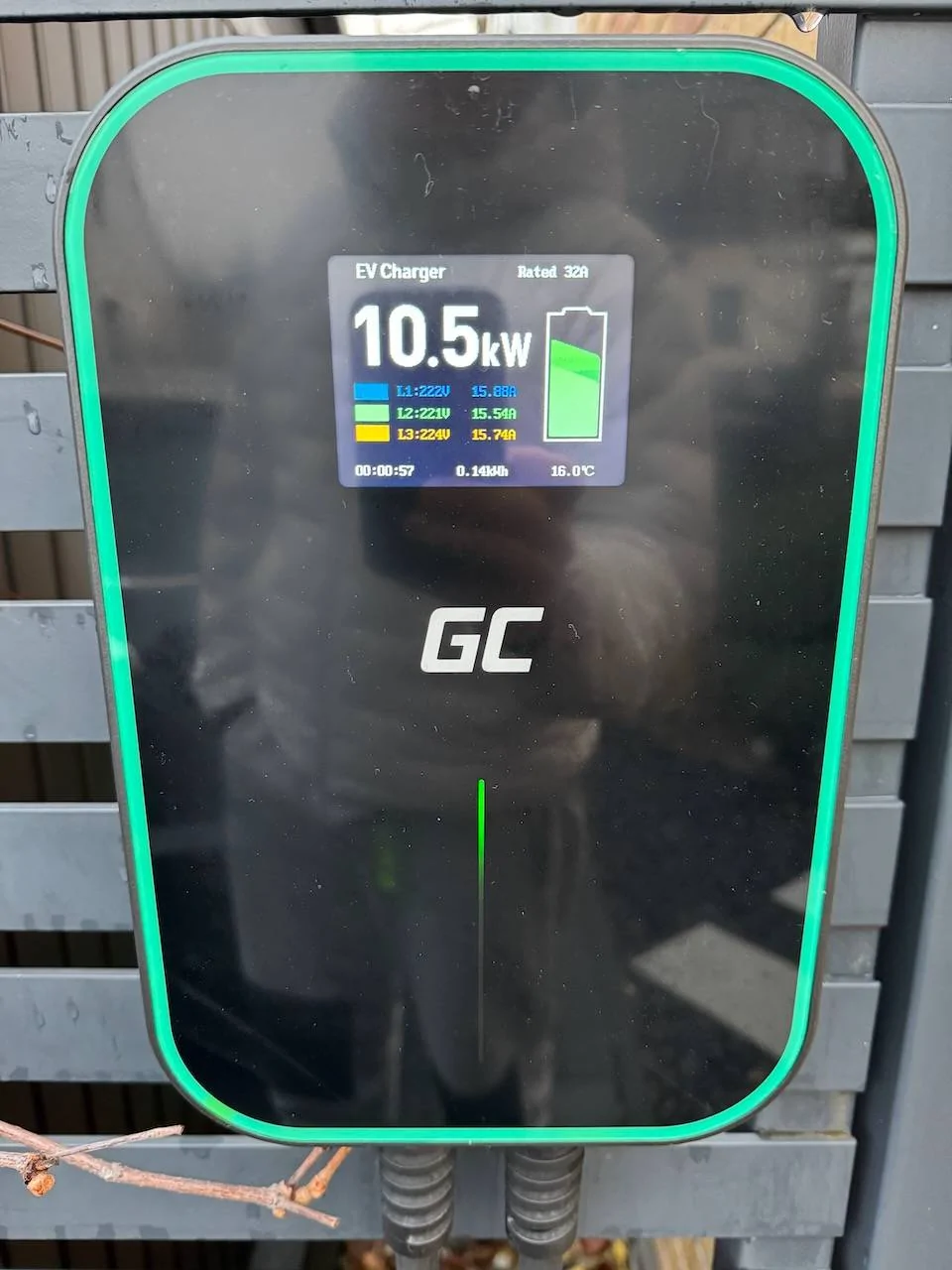

Can confirm it goes above 10 kW both in the app and the charger.
Had it above 11 kW.
Hmm, I'm just trying to interpret the display here. Is it meant to show the voltage and amperage in each phase on the circuit (L1, L2, L3)? So roughly say 222.2 volts x 15.7 amps x 3 = 10.5 kW +/- ? It's not clear to me that it would work that way (I didn't think that you could just add the current in each phase), but the numbers do seem to add up. (But then I am confused by the "Rated 32 amp" display.)
ChrisFromUK
Nov 27, 2024
92
71
Interesting observation David.
I think Rated 32A relates to each of the 3 phases being 32A which would give the normal 22kW limit of a 3 phase AC charger - at least here in Europe.
And I also wonder if you are on to something with regard to the charger wiring.
Lots of guesswork now but the Porsche might limit itself to a max of 9.6kW on a single phase even though it might support 11kW (or 10.5kW really) when spread over 3 phases of supply - which is what the screenshot is showing it can do.
I have no idea how US chargers might be wired to provide 11kW, are they always 3 phase or can a single phase supply provide >7.2kW (which would not happen in the EU/UK; it would always be 3 phase of up to 7.2kW each).
