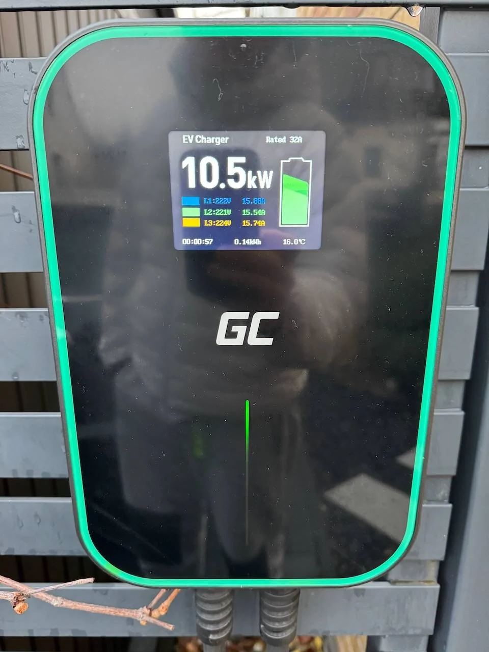

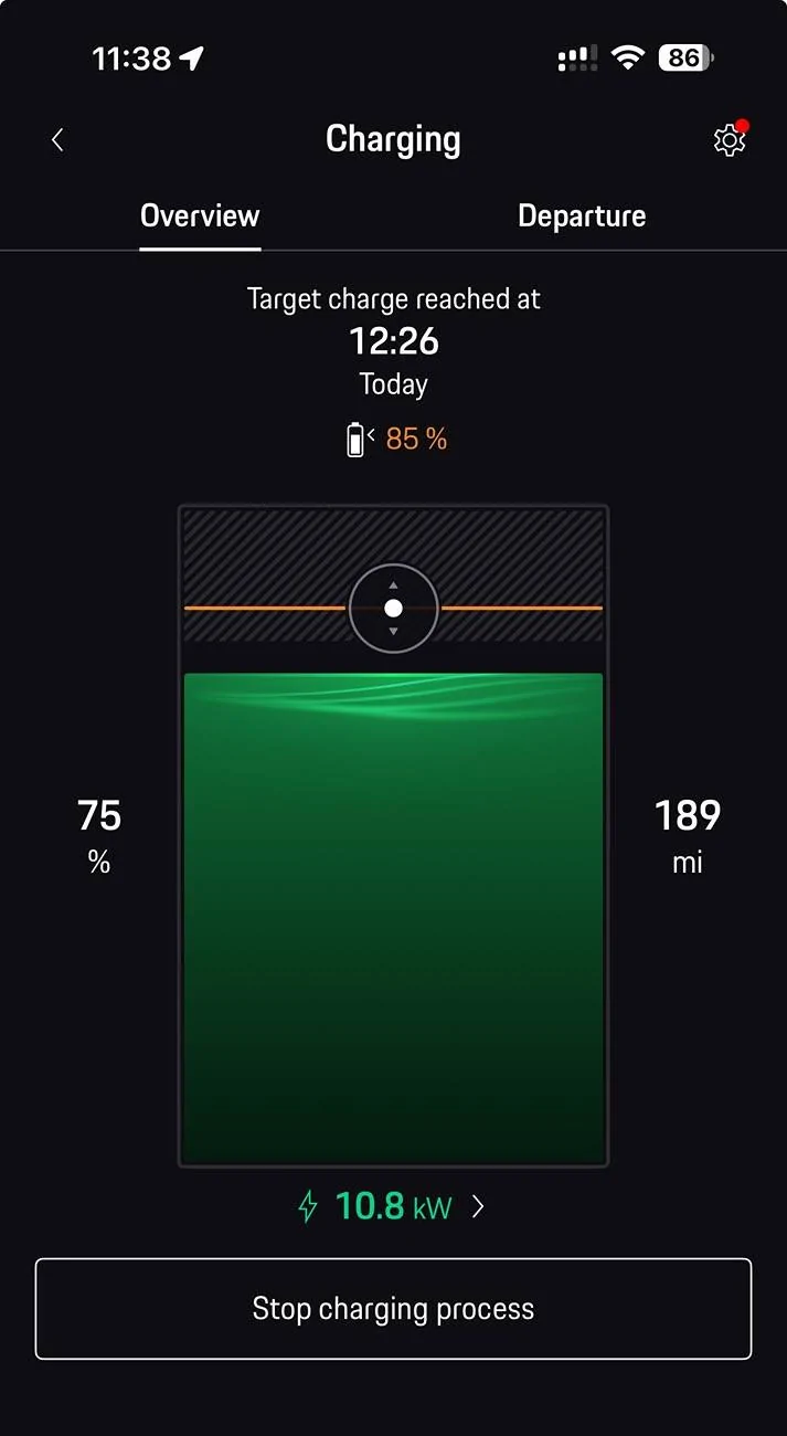

Can confirm it goes above 10 kW both in the app and the charger.
Had it above 11 kW.
