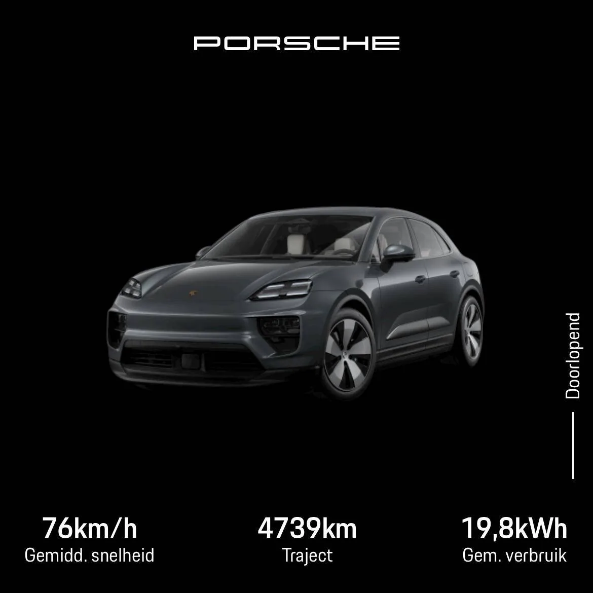

Made a 32 mile trip this afternoon, mostly freeway with the Adaptive Cruise Control set to 85 MPH and InnoDrive engaged to handle the mundane driving duties. A brief triple-digit sprint to get around a slow-moving vehicle in the passing lane (there were four lanes, stay out of the passing lane if you want to go slow). Air conditioning set to 64F with an outside temperature of 76F. Ten minutes of seat massage. Fifteen minutes of heavy traffic with moments of not moving.
In the end I averaged 46 MPH and a consumption of 4.3 miles / kWh.
