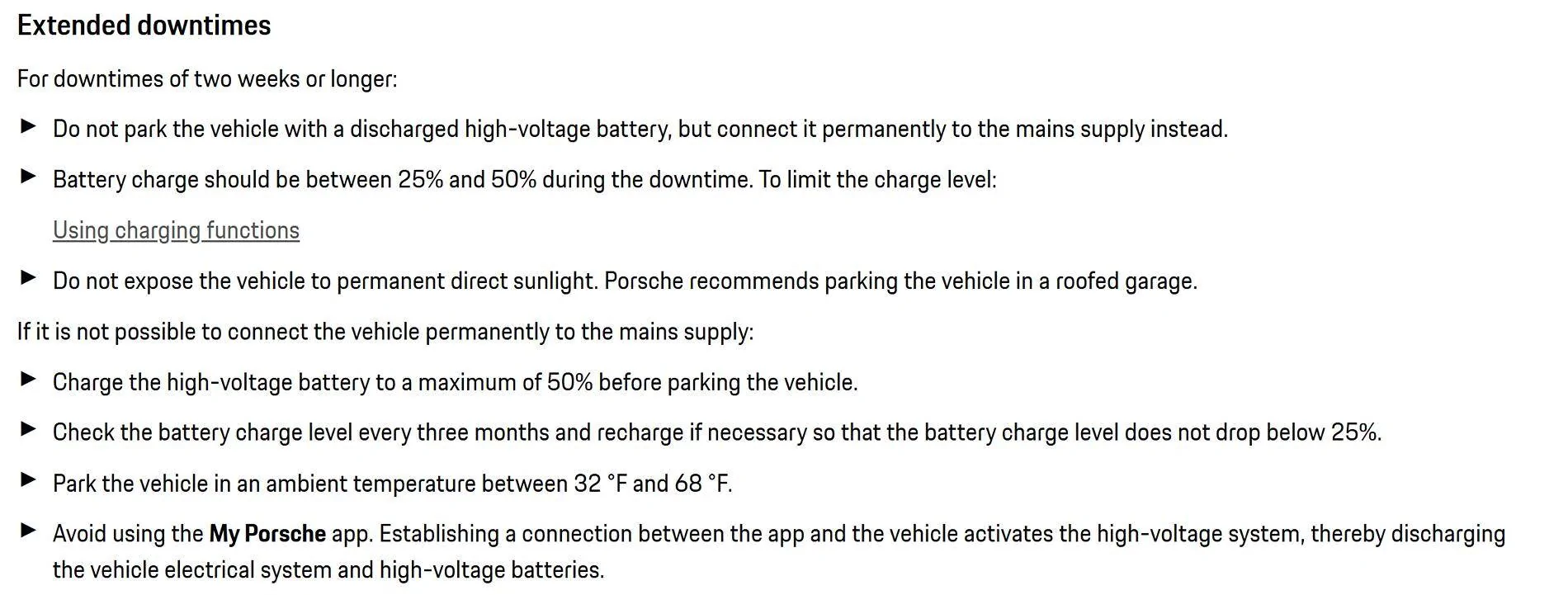

No, the car was not plugged in. I hadn't noticed that in the manual nor can I find it now. Where does the manual say this? How would plugging it in solve the problem?
This is what the manual says, however, this does not give me assurances that 12v will not go flat without a trickle charger:

Based on what I'm seeing here, seems the genius engineers over at Porsche designed it so the 12V is only charged if the car is on? Otherwise you have to keep it plugged into a battery maintainer?
Under
Yeah I stupidly assumed keeping the car plugged in meant the car will ensure the 12V is also kept charged.. but it doesn't appear to be the case?

if the 12V gets charged when the car is on, and opening the My Porsche app turns the car on, then we can just write a simple automation to open the app every few days to ensure the 12V doesn't die, thereby removing the need to connect trickle charging. is my understanding correct?
603
503
So in the scenario, were you going on vacation for 2 1/2 weeks ( or some long term period when you’re not using the car and it is not plugged in) Why couldn’t you just open the app up every few days let the battery top up or charge. as long as you turn the car off the HV battery will still maintain more than the minimum level needed. Or am I missing something?

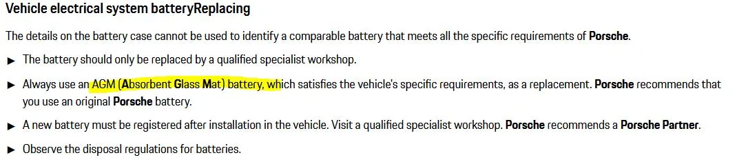

Macan EV uses lithium-ion. That is not the issue we are talking about.
The issue is that HV battery does not charge 12v battery properly allowing it to lose charge and lock up. The manual seems to indicate that 6 weeks is the time needed for 12v to discharge:
Are you sure the auxiliary battery is lithium ion type? I don't have my Macan yet, but the manual indicates that it is AGM (lead-acid) type.
There is no way just connecting to the car will trigger the HV to power on. You'd need to do something that requires HV power, like climate control. But at this point, there's no guarantee that just because the HV is connected, the system is going to recharge the 12V, doesn't seem like Porsche applied much common sense to this part of the car.
