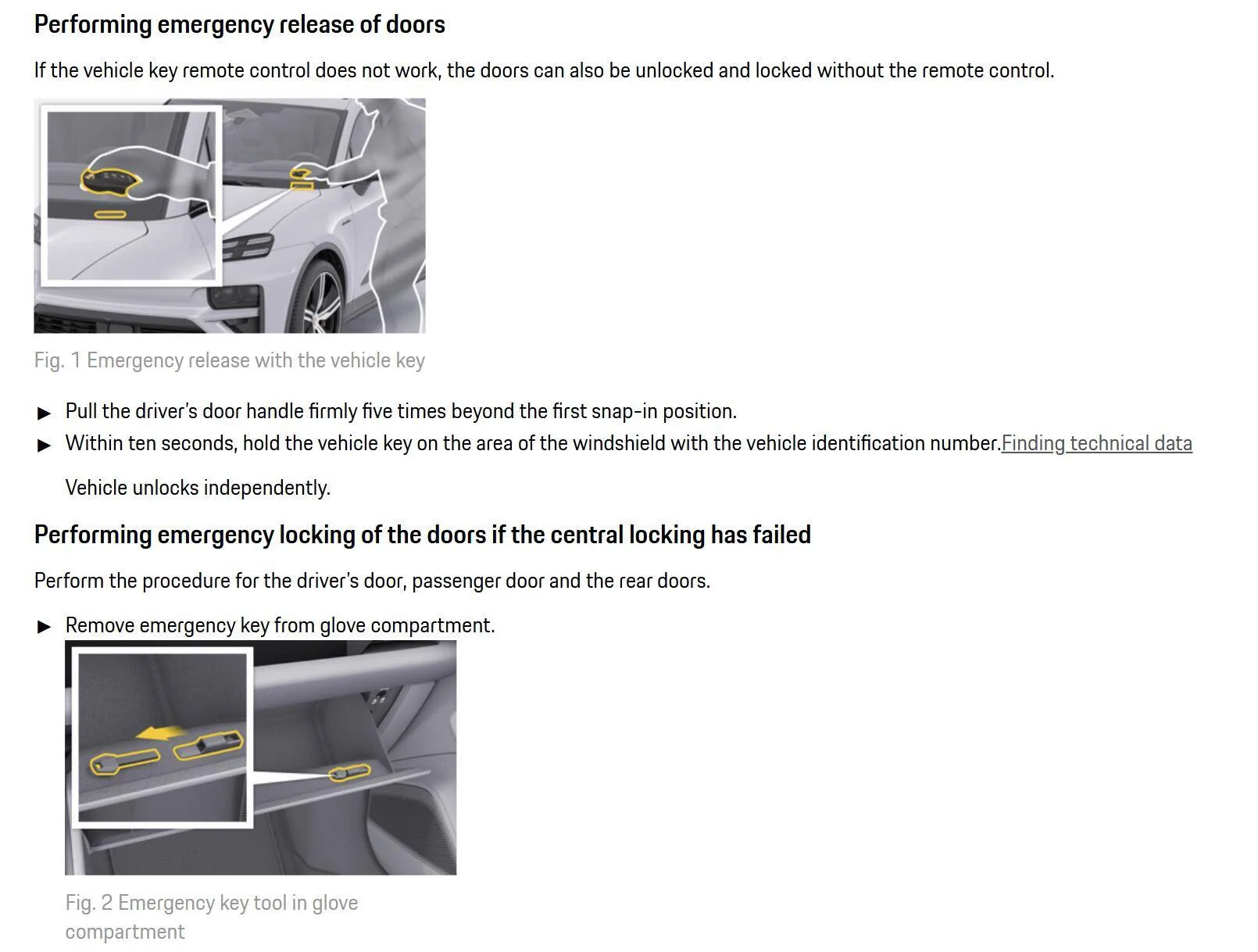

This is what I found and this is a very new and unusual way to do it, compare to other Porsches with emergency key built into the keyfob. This is just the beginning. There are more steps to it.
Electric Macan EV Serious Design Flaw - No easy access to vehicle if 12v battery is very low 1738531608744-s5
490
276
I hope you’re right but I read that as being used when the fob is dead not when the 12v is. As the doors are electronic then don’t they need the 12v battery to drive the unlock ?
