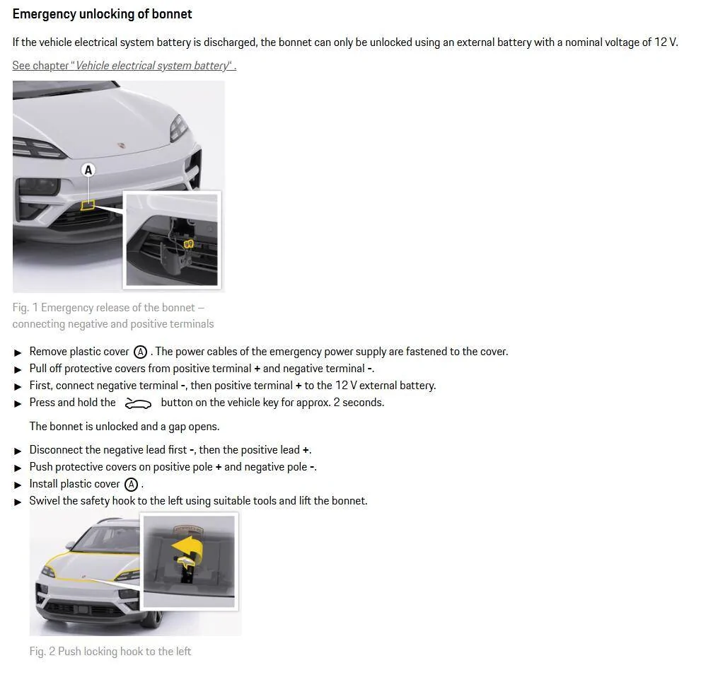

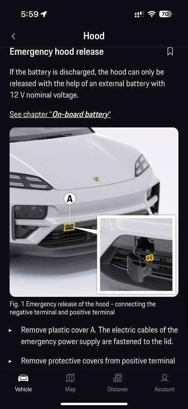

@DHS That's for the Taycan, Macan is not at all that complicated:
To expand on @CandianPorsche83 instructions below, it doesn't look too difficult or require special tools:
