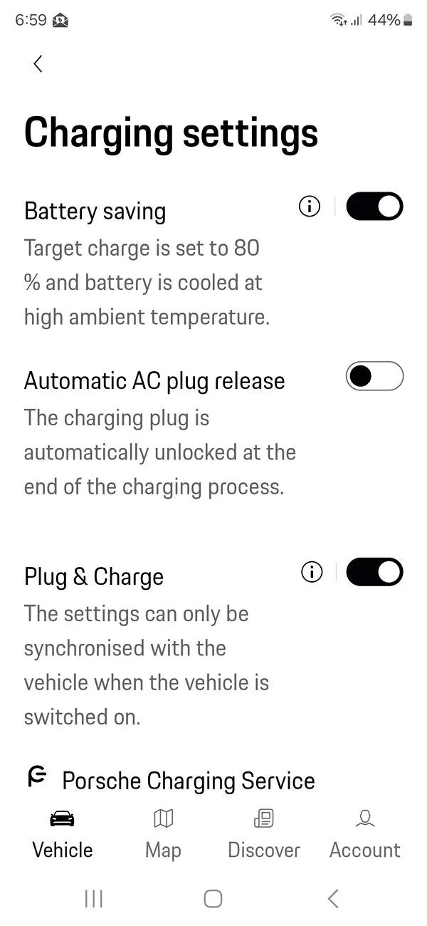

I would definitely enable the battery preservation feature to limit charging to 80% under those conditions.

It would be useful to have Battery Saving icon turned on, as shown here.
What it does is cools the battery at high ambient temperature.
My understanding is that this option is meant for leaving your car parked and unattended, such as for a vacation. It sets the battery to stop charging at 80% (if plugged in) and monitors the temperature to keep the battery cool.
The car will obviously cool the battery as needed when you're driving it, regardless of this setting.
